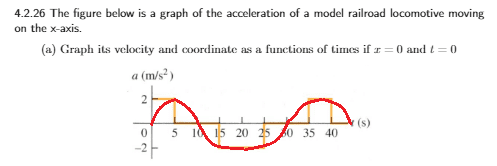

ok not finding this easy but the red is mine drawn over the given book graph
also want to convert the whole thing to tikx graph

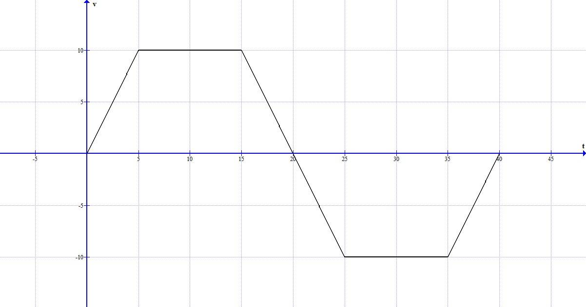

Is the problem's given acceleration graph the piece-wise linear graph in yellow?
Why the graph in red? What's its purpose?
yes only the red in mine
we are asked to plot velocity(red) over the given graph of acceleration

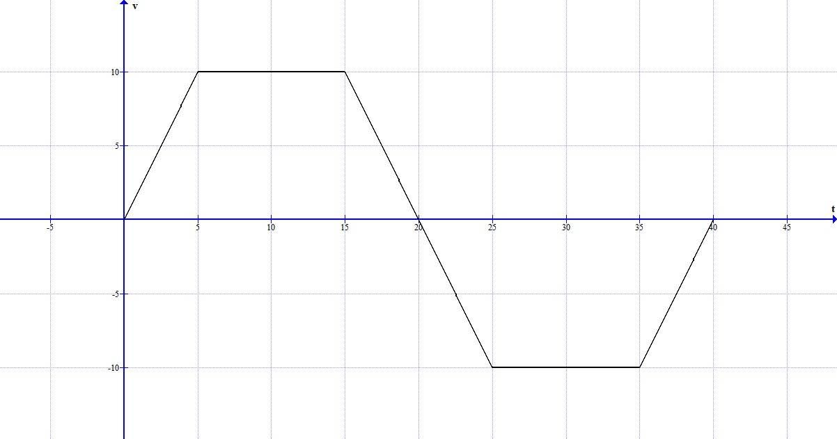

for the given piece-wise linear acceleration graph in yellow, the velocity graph is as shown ...
