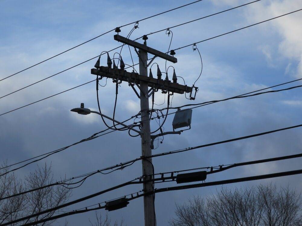

Hi all.
This is probably a simple question, but I am hoping for some guidance on why a service would be delivered with 4 wires as seen in the image. It appears fairly common around here (northeast U.S.), if not standard, for one of the phase-conductors to be 'double-tapped' and go underground as two separate insulated conductors. I can't wrap my head around the purpose of this.
I've seen it for school campuses, larger businesses, etc. (not residential). In the image below, you can (hopefully) see that the conductor on the far right is tapped twice and sent underground as two separate insulated conductors.
My best guess is that they are sending 3 conductors to a 3-phase transformer and the fourth to a separate single phase transformer, but I'm not sure why they couldn't make the split after the burial, or why they would do that to begin with.

It looks to me like two single phase loads, perhaps to different transformers/panels. There does seem to be a symmetry problem with 3-phase, or 3-phase plus single phase. That current has to come back somehow.
Electrical codes don't like splices. Not that you can't do it, but it costs money to add an interim distribution box to do it. What they do like is standard configurations, standard wires that go to standard devices in standard panels.
Interesting. Is it pretty common to step down off two phase conductors? In the rural parts where I reside, residential service is almost always delivered from a phase conductor to a neutral. Maybe not always, but by far most common. (Cities and apartment complexes perhaps become a different soup?)
I didn't think to check if the neutral was run into the conduit. I can see it in the pic, but I'm not sure if it goes into the pipe or just to ground.
I'm not sure I understand the advantage of the set-up as you mention vs running 2 phase conductors with a neutral and sharing the neutral (leaving you with a 1:1:1 current configuration when balanced, right?). Would it just be the increased voltage available for the primary?
It would seem running four insulated conductors would cost more than just running 2 with a neutral... but there are a lot of components I'm not considering or familiar with.

IDK. There are a lot of possible configurations out there. It could be a split phase neutral as you say. Maybe they need to run insulated wires in the conduit for that? If so I would think you'll see some marking near the ends, like a wrap of tape.
One possibility is that they want to distribute 3-phase and for customers that only need 1-phase they run line to line into a transformer. Then they can deliver 3-phase to those who need it and can also balance multiple 1-phase loads in their branches. It's certainly not what we see in suburban distribution, but may be optimized for flexibility. If they want to run higher voltages, then they'll need transformers anyway. You may understand it better if you can figure out where that conduit goes and look at the box it's connected to.
I used to work for a company that sold equipment that required about 20KW or 50KW 3-phase that was rather sensitive to balance issues. Occasionally, I would hear of some pretty strange (very) rural distribution schemes, like 2-phase with 90 degrees, which always sounded just plain stupid, but I'm sure they knew better than me.
That could be a single (split) phase with the 2 phase conductors on the left, and the grounded conductor on the right. If you look closely at one of the "double tapped" conductors it seems to be at a very sharp angle to enter the conduit. I think that is used to bond (ground) the metal conduit to neutral. Using a second coductor is easier than bonding the neutral. In NY state any pipe coming out of the ground , subject to vehicle traffic, must be rigid or protected from damage. Any metal parts must be bonded. That looks like galvanized rigid conduit going up the pole.

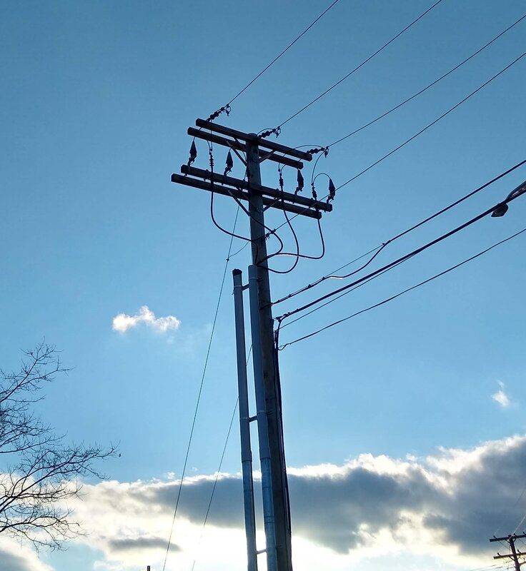

Here's another angle. Doesn't help see that wire you describe, but you can see what's going on with the neutral a bit better.
I'm not working on this, so not likely to see the interior equipment, but if I find someone local in the know I'll report back.

Ground is ground and neutral is neutral, they only connect at specific locations, like a transformer or a service panel. This is to avoid currents flowing through grounds or potential differences between grounds. If that conduit is metallic and buried, it is grounded. If it's metallic and not buried, then it will be connected to a ground system (which isn't neutral). If it's plastic, it's not grounded.
Residential and other small loads will be single phase - single phase transformer, if you have two then you need 4 leads : Trans 1 = Ph A and B, Trans 2 =Ph A and C.
Over the total distribution feed there will be many drops and the load is balanced by managing the connections to the other drops.
Another option is the load could be open delta, kinda rare these days, but feasible for sure.

The picture in the OP shows three insulated wires, with one wire below. The wire below appears to be a common earth, bonded to everything, rather than a neutral.
The three insulated wires could be two 120 V, 180° phases on the left, with a neutral on the right.
The four insulated wires entering the conduit then supply neutral and 120V to two separate distribution boards.

I think there is still some confusion as to what is in the picture. But I don't blame anyone, rather the picture or my communication of it.
No, the picture shows 3 uninsulated phase conductors coming directly off a distribution grid. Then those wires are 'tapped' (proper term?) and transition to insulated wires which enter the conduit. The catch is that one of the phase conductors is 'tapped' twice and sent into the conduit as a separate wire.

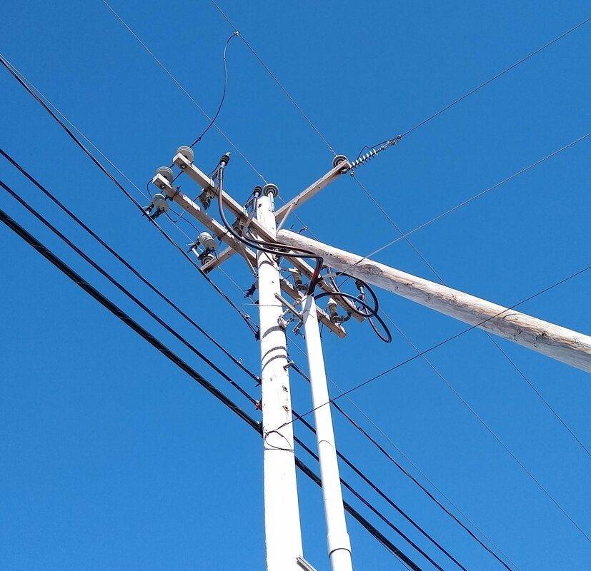

I have another (potential) clue or two:
The 4 wires have color coding (tape or whatnot): red, orange, white, and blue. At least on the one I checked, the red and orange were the two coming off the same phase.

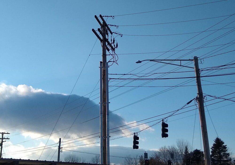

Here's another picture, and it's of a different pole going to a school. Unfortunately I couldn't get a good angle, and you'll have to take my word that the insulated wires are coming off the phases as I describe. Note this one also has a more typical uninsulated tap and neutral feed which goes to a clearly visible pole mounted transformer. I.e. a separate delivery. There also appears to be a large ground mounted transformer or something near that other pole.
Another clue, is that I have since also noticed two wire systems where a SINGLE phase conductor is double tapped (at distribution voltage) and sent underground. What the heck? This just seems so strange to me. It is nothing more than parallel conductors at the same potential, unless I'm missing something. I may find a pic of that later and post if this thread is still going.
Obviously the wires in the conduit will be insulated. I refer to the porcelain insulators that support the aerial wires, otherwise insulated by air.
Surely the Earthed wire without porcelain insulators is not the neutral. So there are only three distribution conductors involved. If one of those is neutral, then there can be only two phases.

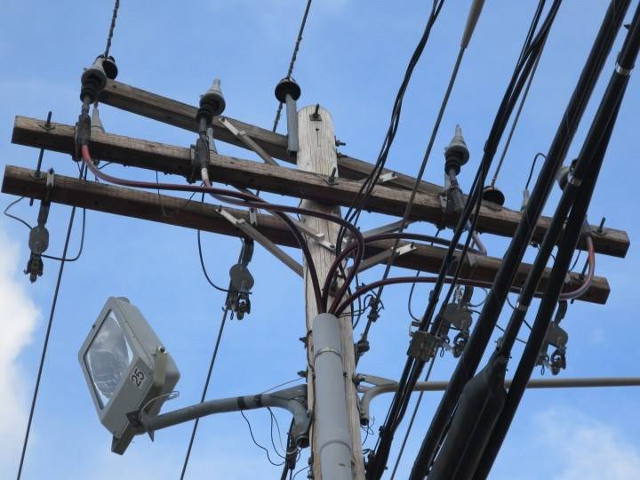

I won't continue to post endless photos, but here's one last one with a clearer shot of the 'taps.' This is yet another service (they really are all over the place). In this case the orange and blue tagged wires are the ones sharing a phase conductor, so that's not consistent.
The two wire system coming off one phase I mentioned in the previous post turned out to go into two separate conduits, whereas this all goes into one. So perhaps not related at all. It almost seems like this could be an open-delta, open-delta config, but wirenut says they are not common and this config seems pretty common.IMG_7639.JPGIMG_7647.jpg

I've seen this before and it's more common on Underground riser poles than overhead. No reason apart from there just not being enough overhead room for more than 3 transformers. The answer is probably as simple as one phase is feeding a separate single-phase panel close to another panel servicing a 3 phase load. The only way to know for sure is to get a look at the load center(s). It's just costs less to have one pole serving 2 or 3 load points than having a separate pole for every load point.
Of course, I could be seeing the pictures wrong. It looks like there are 2 conductors on one of the phases.
