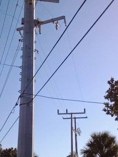

I am in The Florida Keys right now. Here, there is only one highway, and one set of poles/towers. They are forced to carry transmission and distribution and communications on the same poles/towers. On a global scale that is unusual, but in some places it is normal.
zoki85 gave you the best practical advice: look overhead at the number of wires, and the number of insulators, and try to figure out their function and the voltage level.
Here is a picture of a pole/tower in my vicinity. I show it not to overwhelm you, but to illustrate just how much you can teach yourself by looking carefully and trying to reason out the functions one step at a time based on what you actually see.
From top to bottom:
  1. A single wire with no insulators. This is the shield wire that protects the pole from lightning. This wire carries no power.
  2. Three wires with many insulators each. This is a three-phase power transmission circuit.
  3. Two crossbars with three wires each, and fewer insulators. (fewer insulators means lower voltage) These are two three-phase distribution circuits.
  4. A single mystery wire. You can not be certain by looking that its function whether power rather than communication. I believe it is a single-phase low voltage distribution cable with two insulated conductors inside a plastic sheath and spiral wrapped on the outside with a bare wire. Zoom in and look carefully and you can see that the spiral wire is grounded to the tower.
  5. Two wires going off to the left. Look carefully and you can see that they have no insulators at all. They are attached directly to the metal tower. These are not electrical wires, they are guy wires helping to support another pole on the other side of the highway.
  6. Two black sheathed sets of cables for communications. These carry telephone, and cable TV, and Internet. Possibly, there are both wires and fiber optic cables inside. In all cases (I believe) you will find communications cables lower on the pole/tower than electric power cables. That is required for safety of linemen, and it greatly reduces the chances of those wires getting struck by lightning and thus endangering people talking on the phone.
  7. Not shown in the picture. If you look around the base of the metal tower, you will see that it is attached to an Earth ground.

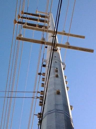

In the second picture below, you see another tower. Three wires from one of the distribution circuits go to nearby wooden poles that supports three distribution transformers (barely visible at the bottom of the picture). Cables from those transformers go to nearby buildings. A black communication cable also branches off to the buildings on the right.
Just stop, look, think, and be patient. The purpose of the things you see may become clear.
