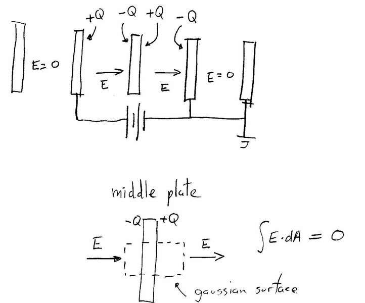

This is what I think is going on, see the attached,
  • Handwritten sketch of five parallel flat plates in a row, with charges labelled +Q, -Q, +Q, -Q on the inner faces, E=0 outside, arrows marked E between plates, wired to a battery and ground; below, a Gaussian surface around the middle plate with its E field arrows and the integral of E dot dA = 0.
This is exactly what I had already mentioned in my original thread.
I am looking to get the points I have bulleted explained.
You wrote,
"Why is the electric field for the gaussian surface enclosing the middle plate (E3-E2)?"
The integral is E dot dA where dA either points outward or inward, therefore as drawn the minus sign, (E3-E2).
You wrote,
"Where does he get the equation,
ρS=ϵ0(E⃗ ⋅nˆ)"
This comes from Gauss's Law, in one form
integral of E dot dA = Q/ε_o
in simple case you have this is simply
E times area = Q/ε_o or
E = rho/ε_o
