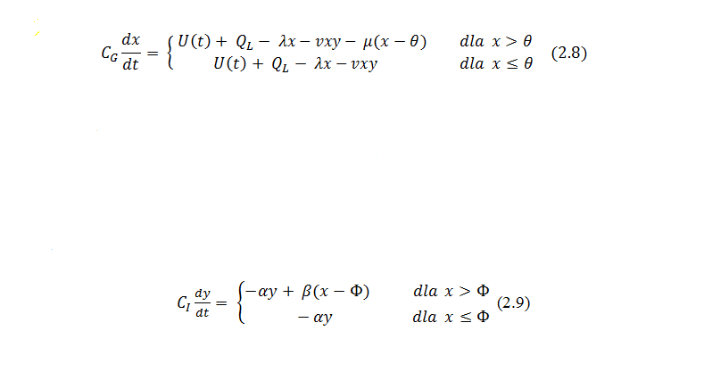

Hello!
I am trying to solve two differential, non-linear equations in C# using fourth-order Runge-Kutha method.
I implemented them in C#:

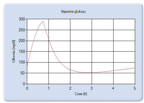

However the results are not that that should be (in comparison to Simulink model).
Do you have any ideas?

Thank you for your response, but unfortunately I do not understand why :)
My solution gives me exactly the same graphs that a simulation in Simulink, and your's does not.
However, you are the master, not me, so I am afraid that you are correct, but please explain :)

If I understand correctly, what you're actually looking for is the function Y(x) which I define to be the area under the curve y(x) between x=x0 and some value of x.
Can you confirm this?
Yes.
Can I assume that x strictly increases with time?
Sample graph is like the one in the attachment. So, as you see x increases, however after some time it dramatically increases, because what I am (We are) creating is glucose-insuline model, and when glucose level increases more insuline is produced and it makes glucose level decrease.
AUC is very useful for me because it helps to model the effect of glycemic index, so if you had a little time I would be very grateful for the calculations. I need more time to think over what you just wrote :)
What do the axes in your graph represent?
Is it an x-t-diagram or what?
And what do your variables x, y, and Y represent?
I presume they are related to glucose level and/or insuline level?
I presume "Czas" is time in hours?
Is "Glikemia" glucose level?
All right.

I just realized there's another differential equation (DE) that you can use.
The advantage is that you get exactly what you got before, but you also get the area under curve as a function of time (instead of x).
The DE is:
dx/dt = fdx(x, y, t)
dy/dt = fdy(x, y)
dY/dt = y fdx(x, y, t)​
That is, just one additional evaluation to keep track of the area under curve.
It will work without any extra conditions.

So you need a different set of DE equations.
So apparently the area under curve is \displaystyle AUC(t) = \int_0^{t} x(t) dt, for t = 2 hours.
This means you can use the DE set:
dy/dt = fdy(x, y)
dAUC/dt = x​
This is much easier! :smile:
