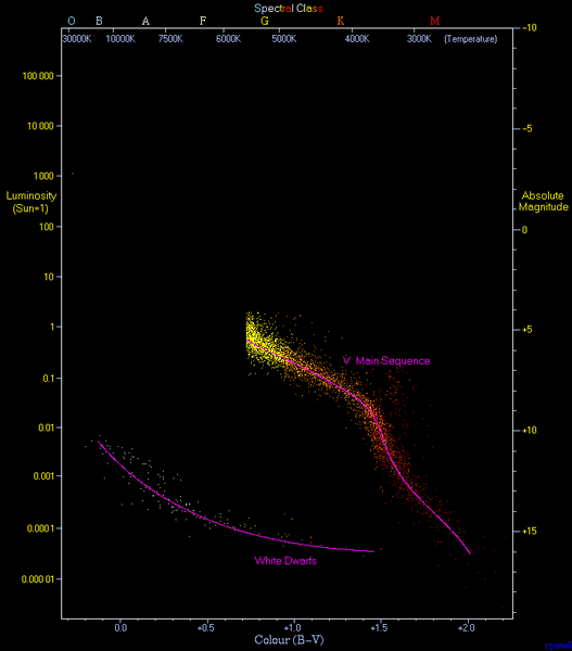

The Hertzspurng-Russel diagram does not let you determine the age of the star. It merely shows "the relationship between the stars' absolute magnitudes or luminosities versus their spectral types or classifications and effective temperatures." -Quoted from wikipedia.
This means that if you have a star that is 10 times the Suns luminosity and and was white in color it would be a Main Sequence star. If the star had 100 times the luminosity of the Sun and was very Red in color, it's surface temperature is very cool, meaning it's grown to a large size and is on Branch III, the "Giant" branch.
http://upload.wikimedia.org/wikipedia/commons/6/6b/HRDiagram.png

This is something you would use a Hertzsprung-Russell Diagram for. The idea is that for stars on the main sequence, the ones that are bluer, hotter, and more luminous don't "live" for as long as the stars that are redder, cooler, and dimmer. The reason for this is that the hotter and more luminous stars have a larger mass. More mass means a higher central core temperature. A higher core temperature means a higher rate of nuclear fusion. Now, the "lifetime" of a star is defined as the amount of time it spends on the main sequence. The main sequence is defined as the portion of the stellar life cycle during which stars produce energy by nuclear fusion of hydrogen into helium in their cores. If the hotter and more luminous stars have a higher fusion rate, then they will run out of their nuclear fuel (hydrogen) in their cores sooner than the dimmer stars. Therefore, the hotter and brighter stars will spend less time on the main sequence. Once they run out of core hydrogen and fusion ceases, the stellar radii and surface temperatures change. This causes those stars to move off the main sequence on the H-R diagram. They move up and to the right onto the red giant branch (corresponding to becoming brighter and having cooler surface temperatures).
The net effect of this is that if you assume that all the stars in the cluster were roughly born at the same time, then there will be certain point on the main sequence to the left of which stars simply don't exist (i.e. that portion of the main sequence is missing). The reason is because the lifetimes of stars bluer than this are shorter than the age of the cluster. So stars of those spectral types have already "veered" off the main sequence and onto the giant branch. We call this point on the H-R diagram at which the main sequence cuts off the "main sequence turn-off point." The older a cluster is, the farther to the right the main sequence turn-off point will be (because in an older cluster even the cooler, dimmer, and more longer-lived stars have "died" i.e. evolved off the main sequence).
So, you can age a cluster simply by looking at where the main sequence turn-off point occurs. The age of the cluster is equal to the main sequence lifetime of the stars at the turn-off point.

see, the way you figure out how old a cluster is by just saying, for example:
There are no stars to the left of F in temperature in the given cluster. How long do stars *right at the point where there are no more stars* remain on the main sequence? That is how old the cluster is.
Like, let's say you look at a cluster and you see the image I attached to this post just pretend you're only looking at the main sequence stars. You can see that there are no stars past a certain point on the main sequence. What we can then say is that the age of the cluster is similar to the time that it takes for a star at that point to leave the main sequence.
So like in this one it turns out I ended up with stars like our sun as the turn-off point. We now say that the age of the cluster is about as old as the time it takes a sun-like star to leave the main sequence.
age of cluster = length of time that the stars at the turn-off point take to turn off.
if you just look at any given star, all you see is the luminosity and the spectra and you can also tell how fast it *looks like* it's heading towards you.
To figure out the age of a star you'd need to know how much fuel it started with and how much fuel it has right now and also the rate at which its using up that fuel. If you could know those things then you could figure out the age of the star. However, all the fuel of a star is in the center of a star, and the fuel that it used to have is in the past and impossible to measure. I think you can figure out the rate at which it uses up its fuel based on its temperature, but that's it.
I THINK I got that right.

I think you've got a slight misunderstanding of what the Main Sequence is. Stars don't start out at the bottom right and move up along it as they age.
What happens is once a star begins burning hydrogen, it appears on the main sequence. The mass of the star is what determines where it appears on the sequence.
Low mass stars appear in the bottom right. This is because they are not very hot and they do not have very much luminosity.
Medium in the middle, and then high mass in the top left.
All three of these things, mass, luminosity and temperature, are directly related to one another. The amount of mass a star has is determined by how much mass was in the gas cloud that it was originally formed in.
The life of a star can be split up into a few ways if we say it starts its life on the main sequence. First it's on the main sequence, after a while it runs out of hydrogen to burn and starts burning other stuff. Once it does this it turns into a giant star, which are the stars over on the top right. After a while it sort of putters out and loses a lot of mass and turns into a white dwarf. This is a massive simplification of how it works, but you can follow the evolution on the H-R diagram.
You start on the MS, move up to the top right, and then you swing over to the left and down into the white dwarf stage.
This is why we can use the method that we've talked about with globular clusters. The higher your mass, the further to left you are on the MS, and the shorter your life span.
But if we just look at a star and know its mass and position on the MS, we can't say how long its already been on the MS because we can't look at how much fuel it has left.
