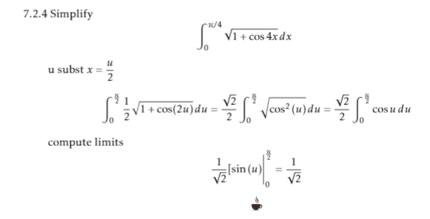

  • Worked integral solution: integral from 0 to pi/4 of the square root of (1 + cos 4x) dx, then substitution u = x/2 giving (sqrt2/2) times the integral of sqrt(cos^2 u) du, then (sqrt2/2) times integral from 0 to pi/2 of cos u du, and final evaluation as 1/sqrt2 times sin u from 0 to pi/2 equals 1/sqrt2.

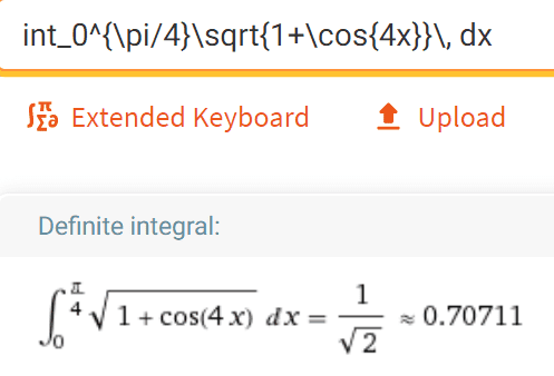

  • Wolfram Alpha screenshot: input int_0^(pi/4) sqrt(1+cos(4x)) dx, and output definite integral of sqrt(1 + cos(4x)) dx from 0 to pi/4 = 1/sqrt(2) ≈ 0.70711.

$$\int_0^{\pi/4} \sqrt{1+\cos(4x)} \, dx$$
$u=2x \implies du = 2 \, dx$
$$\frac{1}{2} \int_0^{\pi/4} \sqrt{1+\cos[2(2x)]} \cdot 2 \, dx$$
substitute and reset the limits of integration ...
$$\frac{1}{2} \int_0^{\pi/2} \sqrt{1+\cos(2u)} \, du$$
note the double angle identity, $\cos(2u) = 2\cos^2{u}-1 \implies 1+\cos(2u) = 2\cos^2{u}$
$$\frac{1}{2} \int_0^{\pi/2} \sqrt{2\cos^2{u}} \, du$$
note $\sqrt{2\cos^2{u}} = \sqrt{2} \cdot \sqrt{\cos^2{u}} = \sqrt{2} \cdot |\cos{u}| = \sqrt{2} \cdot \cos{u}$ since $\cos{u} \ge 0$ in quadrant I.
$$\frac{\sqrt{2}}{2} \int_0^{\pi/2}\cos{u} \, du$$
$\dfrac{\sqrt{2}}{2} \bigg[\sin{u} \bigg]_0^{\pi/2} = \dfrac{\sqrt{2}}{2} (1-0) = \dfrac{\sqrt{2}}{2}$
ok I see now it was resetting the limits because of substitution
Mahalo
