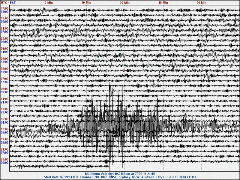

there's a quake on my system at the moment
a M 5.7 up in the Solomon Is. ~ 3500 km NNE of my station
here is the gram before it disappears in another ~ 24 hrs
you can see the short period P and S waves and the long period surface waves on this gram
( each line across the gram is 1 hour --- you can see it marked off in 10 minute intervals)
Small amplitude P wave arriving at 10 mins past the hour, slightly larger S wave at ~ 15 mins past the hour
then around 18 min past the hour the lower freq surface waves start to arrive
The P and S waves have already undergone considerable attenuation by this timecheers
