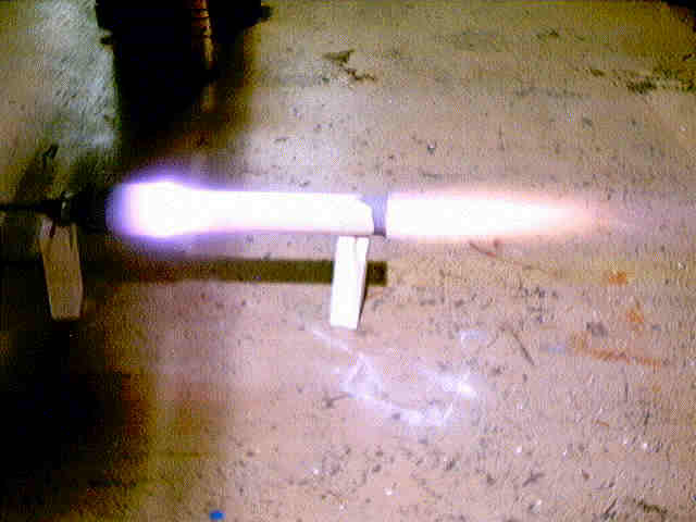

I tried to test run my pulse jet engine today with 80% methanol and 20% diesel but as it turns out diesel will not mix with methanol. Kerosene will not mix with methanol either. It is like trying to mix oil with water.
Today tried to determine the real run frequency of the pulse jet engine. The engine length is 19" long. Using the formula to calculate the frequency of a closed tube i get, 1200 degrees F = 376 Hz, 1300 degrees F = 394 Hz, 1400 degrees F = 411 Hz.
The engine runs red hot we know for sure the engine is hotter than 1100 degrees because metal glows a very dull red hot at that temperature.
The frequency detector says the REAL frequency of the engine is 298 Hz to 303 Hz.
Doing the math the only way I can get 300 Hz the engine temperature has to be 763 degrees F. The only way to explain this is the engine sucks in 70 degree air 300 times per second if the engine is running at 1456 degrees F then 763 is the average temperature.
How is it possible for the engine to run so hot it glows extremely bright red when the average temperature is 763 degrees F.
What formula did you use?
Show your working (with all units) and we can go from there.

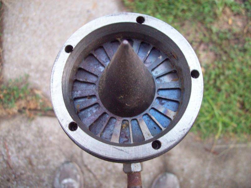

I have moved back to TN. I have experimented a little with my pulse jet engines on the test stand to see how much thrust and engine will actually produce on each fuel. We have been too busy moving into the new house and camping 3 days every week in the RV to play with the pulse jet engines much. Kerosene works better than diesel fuel. 80% gas with methanol + 20% kerosene works best. Pulse jet engines have no trouble running lean but they will not run rich. Easy time the engine fires the exhaust pulse that goes out the tale pipe sucks a vacuum that pulls in the next mixture of air and fuel. Engines start easy at 25% throttle, as I open the needle valve the engine thrust increases to full throttle. 100% being full throttle if I try to throttle up to 101% engine sounds like it is bogging down and thrust drops a little bit. The engine can not suck enough extra air to burn the extra 1% fuel, air intake is limited by how much air can be sucked in through the valves. It I open needle valve to 102% the engine stops running it can not suck in enough air to burn the extra 2% fuel. Forward engine speed produces RAM air now the engine can throttle up past 100% throttle. The engine needs a duel fuel system, one fuel system to start and run at 100% throttle, another fuel system to add more fuel as RAM air increases the engine will throttle up to 140% where 200 mph was max speed before now it goes 280 mph.
No one sells Kerosene anymore.
I have been using 20% diesel fuel and 80% gasoline that contains 10% alcohol it works very well. I need to do jet engine tests on the test stand to compare the same mixture using gasoline with 15% alcohol. I don't think there will be very much difference in thrust an not sure my test stand will show the difference it is not accurate enough to read grams.
