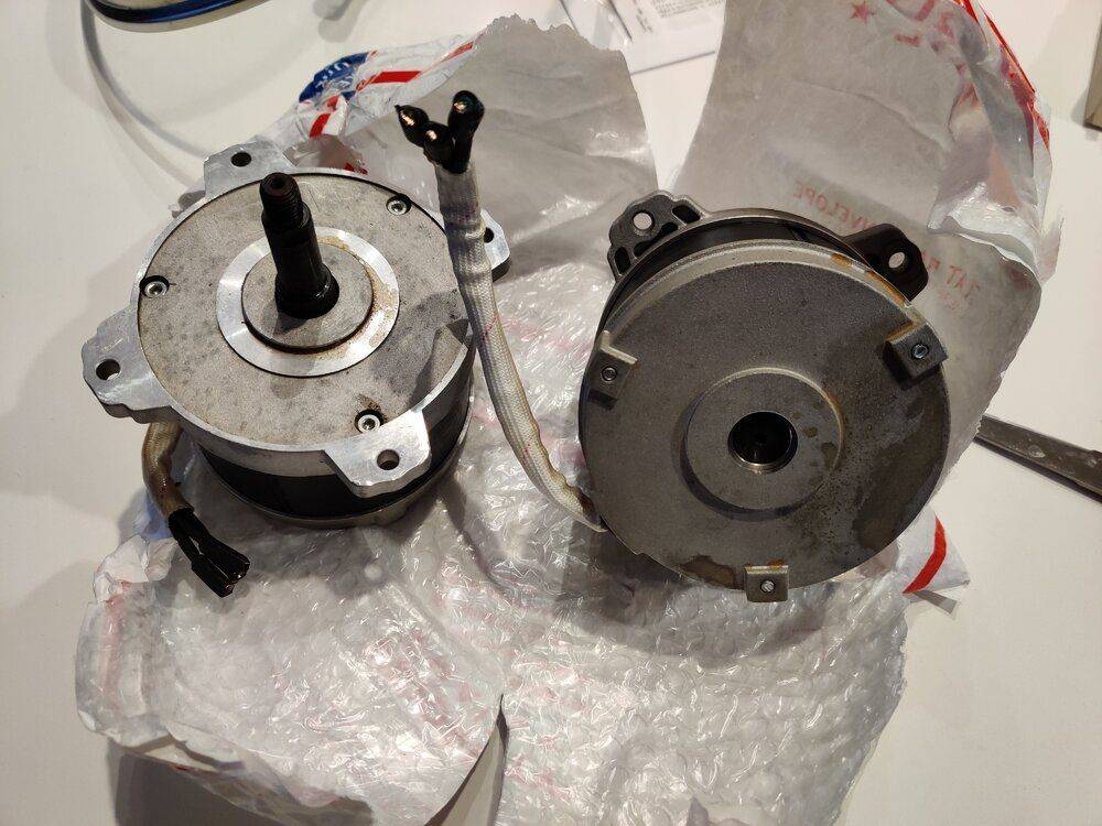

The motors have zero markings on them but I know the electric mower made by ryobi is 40v. Not sure still if they are brushless or brushed. I assume brushed since the OEM would likely cheap out every other could. Heres a pic, they just arrived. Yes I know there's some unknowns which is why I am seeking help. After searching forever to source parts and wanting to save some cash I found these two motors. Basically I just need a controller (or two) to hook them up to a 48v battery. Just wondering if there's a good source for controllers.

Impossible to answer without knowledge of the motors. Controllers are specific to a motor type. It is like asking about a new carburetor without knowing the make and model of the car you own.
Is there an ad or something that you saw to buy the motors? If so, can you post a link.
Looking at the Home Depot ad, new Ryobi mowers claim 40V brushless motors. If the motors have three wires coming out (and probably not colored green or red or black) my guess is brushless. Which really means 3 phase square wave AC is provided by the controller to these wire at the appropriate frequency to make them spin synchronously. But it would certainly be far better to have some specs. What mower model did they come from??
You will need to know the amps to get a controller at very least.
They supposedly came out of a ryobi 20inch electric self propelled walk behind single blade mower. Seems to be only one model. Yes it looks like three wires and the ad says brushless

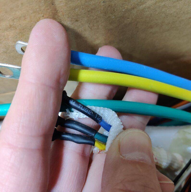

I didn't see one without hall sensor. The wires are probably 14-gauge ? The wires in background are for my drive motor controller which are probably about 8-gauge? I think 22gauge wire can handle 10A so the thickness is likely more for resistance vs amp load? The ryobi controllers I saw have 8A or 10A printed on them.
