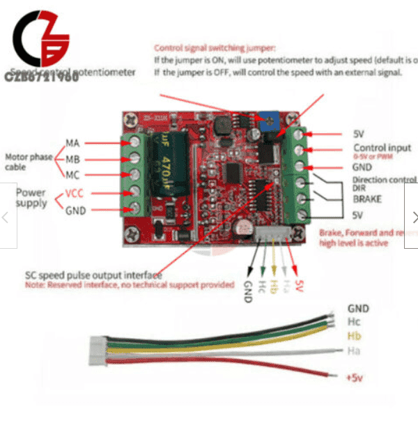

The ebay ad you linked contains the words,
Features:
[TD]Hall Motor Control
[/TD]
I think that is what @Tom.G referred to.
Edit: It also includes the wiring diagram for the controller.
Ok I think I found a controller that would work, what do you guys think of this one? I would get two, one for each of the 40V ryobi motors:
https://www.ebay.com/itm/DC-6-50V-3-Phases-Brushless-Motor-Controller-No-Hall-BLDC-PWM-PLC-Driver-Board/253794933276?hash=item3b175b5a1c:g:~rsAAOSwLXFctH63
16A peak 20A
6-50V operation (my battery is 48v)
built-in pot for speed
No hall (I thought I could just leave that disconnected)
I note this is also available at Banggood where there is some more info. I think this will do well and don't really know exactly what the (hall) speed sensor does so this probably better. These motors can probably go faster than you can safely go incidentally...

Yes, I think 3 wires means BLDC motor. Here's some tests you could try:
1) Measure the resistance of all 3 combinations of terminals. If they aren't all the same then it's not a BLDC motor.
2) Connect the windings to an oscilloscope and spin the motors. If you see three identical sine waves (back emf) 120o apart, then it's a BLDC motor.

Update...So I have the drive motor, controller, throttle, battery etc all on the bench and it seems to be working well. I am waiting on the controllers for the two deck blade motors still. More on that later...
i have a question on the fuse (don't have one yet). Not being familiar with these brushless motors, it is a 2000w motor on a 48v battery so if I divide I get 42A so is there a spike under load? Anyone have an opinion on whether a 50A slo blo would be ok? Or do I need to get one that is closer to 40A?
The fuse size also depends on the characteristics of the controller; and if you expect the fuse to also protect the controller.
For instance if the controller has Soft Start, Current Limiting, and built-in protection to an overload, put a 100A fuse at the battery to handle both of them (and probably another controller and fuse for the traction motor).
If the controllers do NOT have Soft Start, Current Limit, etc., use a separate fuse for each power circuit (probably a 60A-75A Slo-Blo) to handle the motor start-up and when the blades hit something solid. The electronics in the controllers are effectively a very fast, expensive, fuse; as such, they protect the fuse by blowing first. :cry:
Cheers,
Tom
(Note: Be sure to have spare fuses on hand, and maybe a controller!)
