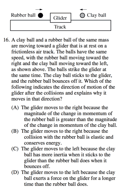

Thanks, haruspex. This appears to be a mistake by the American College Board. Actually, a small apology: I wrote down A and D as the relevant solutions; that should have been A and B, but it appears to me that B is also incorrect. Here is the original question
That is rather different.
As you originally posted, the glider moves to the right because momentum is conserved, but that is not the reason provided in A. So we know the answer is A or B, but which offers a valid explanation?
E.g. for A, is it true that:
  1. The clay ball undergoes the greater change in momentum, and
  2. That proves it moves to the right
Edit: I meant
  1. The rubber ball undergoes the greater change in momentum, and
Thanks again, haruspex. Precisely the apparent non-sequitur between the change of momenta and the direction made me pose the question. Answer A sounded better than answer B
But the connection between conservation of momentum and the way the answer is stated in A is not clear. However, to justify that at least the clay ball undergoes the greater change of momentum, I reasoned as follows:
The difference in the change of the magnitude of the momentum of the rubber ball versus the change of momentum of the class ball comes down to a comparison of the momenta after the collision, because before the collision the momenta (magnitudes) are equal.
Because after the collision, the momentum of the rubber ball (after) = the magnitude of the momentum of the (clay ball+ glider), that is,
Mvr= (M+m)vc > Mvc
So, the clay ball undergoes the greater change of momentum.
But I could see even less connection in the explanation given in answer B, because the whole system includes an inelastic collision, so the kinetic energy is not conserved, so the whole system is an inelastic collision, not an elastic one. Therefore to say that the collision of the rubber ball is an elastic collision is not really meaningful.
Therefore, I am still confused as to what answer would be the correct one (there is no "none of the above".)
These questions are poor, IMHO, because there is no one reason per se. The fact that the balls are of equal mass is important. If the clay ball were more massive, then everything would move to the left after the collision. And, as you pointed out, the fact that ball A is physically constrained to the left of ball B is also important.
Energy does not have a direction. Momentum is the vector quantity, so seems more directly related to the final direction of motion than energy.
My argument, however, would be that both energy and momentum are relevant to a collision so you ought to consider both in looking for a solution.
If I were learning the material I would be satisfied that I could analyse the problem using both energy and momentum and that's all that's important.

I think we all agree that by using conservation of momentum it is clear that the glider will move to the right. That was set out in post #1. (No need for M>>m, is there?)
But that does not answer the question posed. It requires us to consider some other lines of reasoning and say which of them leads also to that conclusion (validly).
That said, as I showed in post #8, none of the options achieves that.
I see that nomadreid offers another interpretation in post #10, but I am not persuaded. The original phrasing seems perfectly clear.
Collision involving three bodies can not be solved in general without detailed knowledge of the collision process.
Here, option A is valid and clear if m<<M.
B is not, energy is not conserved in the process, and if conserved, it does not say anything about the direction of the velocities.
C speaks about greater inertia of the clay ball - has it sense?
D is about time of interactions, which can not be validated.

How so? How does merely knowing that the change in momentum of the rubber ball has a greater magnitude than the change in momentum of the clay ball imply that the glider moves to the right?
Bear in mind that you cannot use the other given facts, like equal masses and speeds, in answering that. This is a question about logical inference.
E.g., as I wrote in post #8, we could increase the mass of the clay ball to such an extent that the glider continues to the left and yet the rubber ball still has the greater momentum change. Thus, the predicate does not imply the conclusion.

The OP solved the question of which way it moves in post #1, using conservation of momentum, and making no assumptions about the mass of the glider. But as clearly laid out in post #3, that is only part of what is being asked. It says "and explains why it moves in that direction".
Option A says it is explained by the rubber ball having the greater change in momentum. Well, it does have the greater change in momentum, but does that constitute an explanation?
To assess that you cannot go combining it with all the other known facts and ask if that combination leads to the actual movement. For the reasoning to be valid, the conclusion must follow purely from the predicate; and it does not.

Consider the impulses delivered to the glider by the two balls. If the change in momentum of the rubber ball is greater (in magnitude) than that of the clay ball, then there will be a net impulse to the right. Isn't that sufficient? I think choice A does it with the tacit understanding that Newton's 3rd law comes into play.
From my post I would say reason A. Change in momentum of ball A equates to the collision impulse. The impulse for collision AB is twice that for collision CB. For elastic collisions impulse Δp = 2μΔv and for perfectly inelastic it's just μΔv. But the result Δp = 2μΔv is applicable only to elastic collisions in which energy is conserved so reason B is equally applicable if a little less 'direct'.
That works if we change A to read "the glider moves to the right because it started at rest and the magnitude.." etc. (Even then, formalising it is quite tricky.)
You may think I am being picky, but the whole basis for discriminating between A and B is that you must put aside all other information. For example, @neilparker62 in post #22 makes the same mistake as several others in this thread of reusing the information that the masses are equal.
I think that both the equality of the masses and speeds of the two balls and the given that the glider is initially at rest are important considerations to the correct answer. If I were to write an explanation, I would say
"The glider moves to the right because the center of mass of the three-mass system is initially at rest."
The connective reasoning then is (a) because momentum is conserved, the CM must also be at rest after the collision, therefore the rubber ball and glider+clay ball must be moving in opposite directions or not at all; (b) the "not at all" option would be the case only if both balls stick to the glider (c) because the rubber ball cannot go through the glider, it must reverse direction, therefore the glider+clay ball must move to the right.
This reasoning also shows that the collisions need not be simultaneous. Regardless of the order of their occurrence, when all is said and done, the rubber ball will be moving to the left and the glider+clay ball to the right.

Statements A and B are both correct in that they can be deduced from the given facts. You could take either of those statements, combined with the original facts, to deduce that the glider moves to the right. Therefore in order to answer the question of which of A and B, if either, is sufficient to deduce that the glider moves to the right you must not be allowed to combine those statements with the other original facts.
I agree so far.
Here is where we part company. I fail to see why this statement necessarily follows. If one "must not be allowed" to combine the statements with the other original facts in the context of choosing an answer, then why were the original facts given to begin with? I think that what necessarily follows is that we have a poorly constructed multiple choice question because it has two answers that can be correct if all the given facts are considered.
That is why you must exclude them. The point of the question, I believe, is to distil that feature of the given facts that, by itself, leads to the result that the glider moves right.
