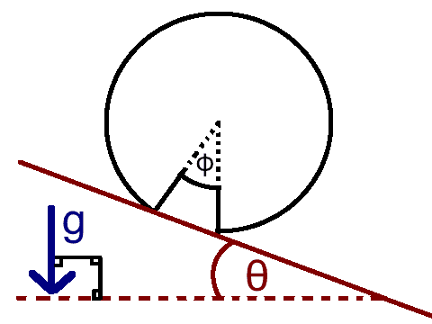

I read this problem in a "book" in my dreams :sleep:so I want to make sure the problem and my solution are not flawed.
(I modified it a bit when I woke up; you know how dreams can be o0))
A cylinder of radius R has a section of angle Φ cut out as shown. After cutting this piece out, the mass is M.
The rotational inertia is then measured to be ##\beta MR^2##.
If the cylinder is now placed on an inclined plane of angle θ with the horizontal, then the center of mass may approach an average-terminal-speed.
(Averaged over a total cycle, i.e. when the cylinder turns 2pi*n radians about it's center; where n is an integer.)
Once this average-terminal-speed is obtained, find the maximum speed of the center of mass of the cylinder.
Assume the cylinder does not slip.
Assume the cylinder does not bounce.
Assume that after cutting the cylinder, the center of mass lies in the geometrical center of the uncut cylinder.
2. General idea for the solution
kinetic energy lost in collision = kinetic energy gained in rolling down the plane
If the CoM speed is too large, more energy will be lost in the collision than is gained from gravity, and the cylinder will slow down.
Similarly, if the CoM speed is too small, it will gain more energy than it loses and speed up.
So the speed will always approach an average-terminal-speed. (Correct?)
Now let us assume this average-terminal-speed is obtained.
When the corner is just about to touch down (as shown in the image) the velocity of the center of mass (call it V0 at that point) will be greatest (which we want to find) and it will be in a direction Φ/2 below the (down-hill) direction of the plane (because it is rotating about the other corner). Since the cylinder doesn't bounce, all velocity perpendicular to the plane will be lost, leaving a final velocity of V0cos(Φ/2) after the collision.
The energy before the collision: ##0.5M(V_0^2+\beta R^2 \omega^2)=0.5MV_0^2(1+\beta)##
The energy after the collision: ##0.5MV_0^2\cos^2(\frac{\phi}{2})(1+\beta)##
The energy lost: ##0.5MV_0^2(1+\beta)\big(1-\cos^2(\frac{\phi}{2})\big)##By the time it gets back to the position in the picture, it will have traveled a distance 2πR down the plane, gaining a kinetic energy of 2πR*sin(θ)*MgEquating the previous two expressions we get: ##V_0 = \sqrt{ \frac{4\pi Rg\sin(\theta)}{(1+\beta)\big(1-\cos^2(\frac{\phi}{2})\big)} }##Is this a valid problem/solution?
(Anything I unconsciously assumed?)
I think I just realized a mistake. The velocity after the collision won't be V0cos(Φ/2) is will be V0cos(Φ) because if it is to not slip then it will pivot about the next corner and so it's velocity initially after the collision will be in a direction Φ/2 above the down-hill-direction of the plane.
So just replace "Φ/2" with "Φ" in my final equation, and that is my new answer.
I agree with this revised calculation.
You are assuming phi is small, or the distance rolled is a little less.
Ahh, good point. The displacement of the CoM will not be 2πR; it will be (2π-Φ+2sin(Φ/2))R ... so 2πR is only accurate for small Φ.
Nice catch, thanks.
