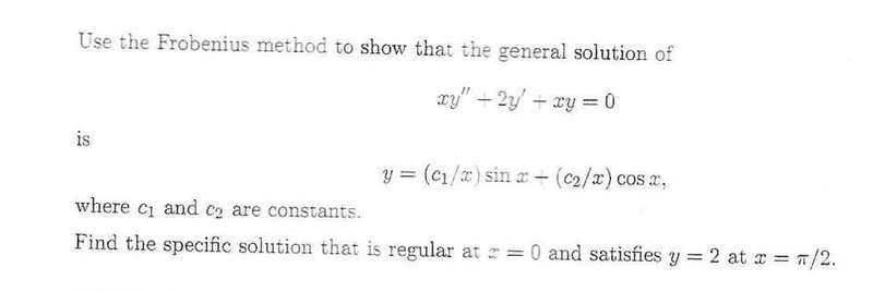

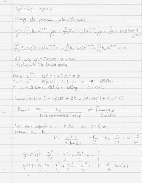

Ok, so i have managed the Frobenius method in the past, but this seems harder...
[tex] \sum_{n=0}^{\infty} a_n(n+c)(n+c-1)x^{\ n+c-2} + 2\sum_{n=0}^{\infty} a_n(n+c)x^{\ n+c-2} + \sum_{n=0}^{\infty} a_nx^{\ n+c} = 0[/tex]
[tex] \sum_{n=0}^{\infty} a_n(n+c)(n+c-1)x^{\ n+c-2} + 2\sum_{n=0}^{\infty} a_n(n+c)x^{\ n+c-2} + \sum_{n=2}^{\infty} a_{\ n-2}x^{\ n+c-2} = 0[/tex]

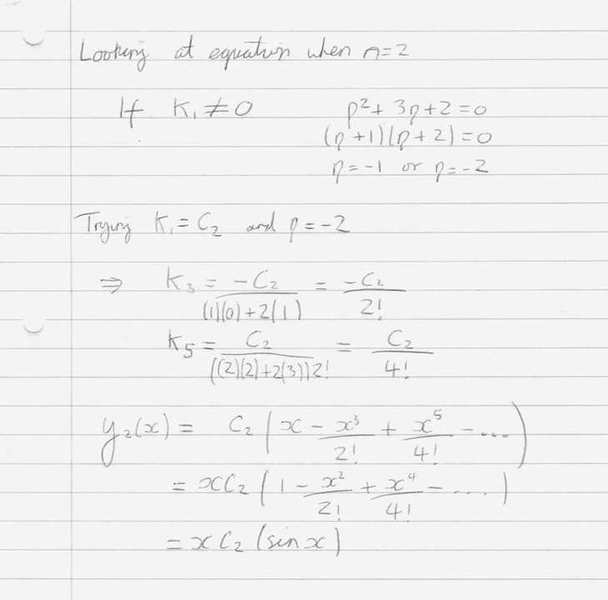

i cannot simply remove n=0 as i would if there were only a difference of one between the sumation limits, here i would have to remove n=0 and n=1 which means that i would not have a quadratic multiplied by [tex]a_0[/tex]to solve, to find the c values. I would have one quadratic multiplied [tex]a_0[/tex] by and one by [tex]a_1[/tex]...
I meant xy'' + 2y' + xy = 0...
To clarify, from the wikipedia article and looking at the example,
'We can take one element out of the sums that start with k=0 to obtain the sums starting at the same index.'
'We obtain one linearly independent solution by solving the indicial polynomial r(r-1)-r+1 = r2-2r+1 =0 which gives a double root of 1'
I have two equations if i remove n=0 and n=1, what shall i do to get my indicial polynomial?
Here is the question:
and my solution:
am i right? is the question wrong? please can someone clarify this.
please...
f uckyall bitchez - i solved it.
