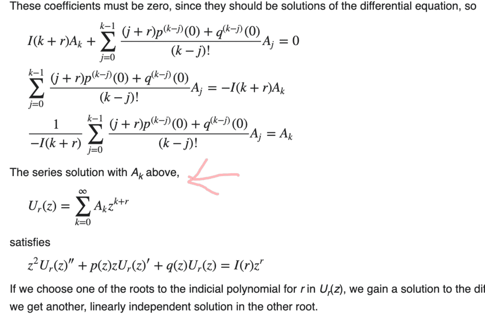

I overlooked that one. Does it say there that you are usibg the Frobenius method to solve the Bessel equation ? (other link , link, solution with pictures, a whole chapter, ...).
And you should really start your power series from ##k=0##, not from ##k=-\infty##.
All this with just a little googling and without sitting down and seriously working out your core question ! Lazy me ... :wink:
My own notes are still somewhere in the attic and also in my brain, but under four and a half decades of dust :biggrin:

i guess the lecturer must have mentioned the method but i probably did not indicate the method on my working...

I think i may be wrong with my limits, ##k## should start from ##0## and not ##-∞##, as indicated...
...now considering case 1, if ##c=n##, and given ##k=1##, then ##a_1=0##...this is the part that i am not getting.
i am ok with the rest of the steps...
This is the part that i need understanding ...lets assume as you have put it that ##k## starts from ##0→+∞## then how is it that when ##k=1##, that ##a_1=0##
or the other possibility is that my statement (my notes) is/are incorrect.
