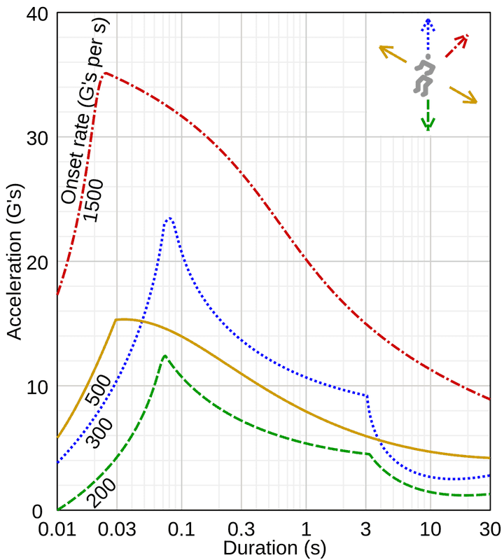

Sundown444 said:
Still, I must say as another reason why I asked; while changing speed and changing direction are part of the same thing, the human body, as I know, is not built to handle everything, not equally, anyway.
Please, see:
https://en.m.wikipedia.org/wiki/G-force#Human_tolerance

I was about to post the same as @Lnewqban but he beat me to it (as usual). :smile:
Beyond simple comfort issues, the real limits to human tolerance of acceleration in different directions is based on our cardiovascular (CV) system. If the acceleration is too high in the wrong direction with respect to our body position, the blood pressure (BP) will drop in our head leading to GLOC and eventually death (one way or another).
So for situations that are important for humans to be able to survive high-g situations for short periods (fighter aircraft pilot/RIO, astronaut launches, etc.), the vehicle ergonomics and accessories (like g-suits) are designed to help mitigate the CV problems and maintain reasonable BP delivered to the brain.
