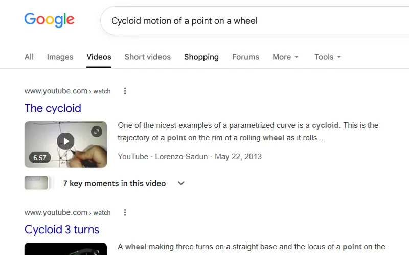

BadgerBadger92 said:
Do you know of any good videos about this? I learn best visually and from videos.
I did this Google Images search and got good hits:
