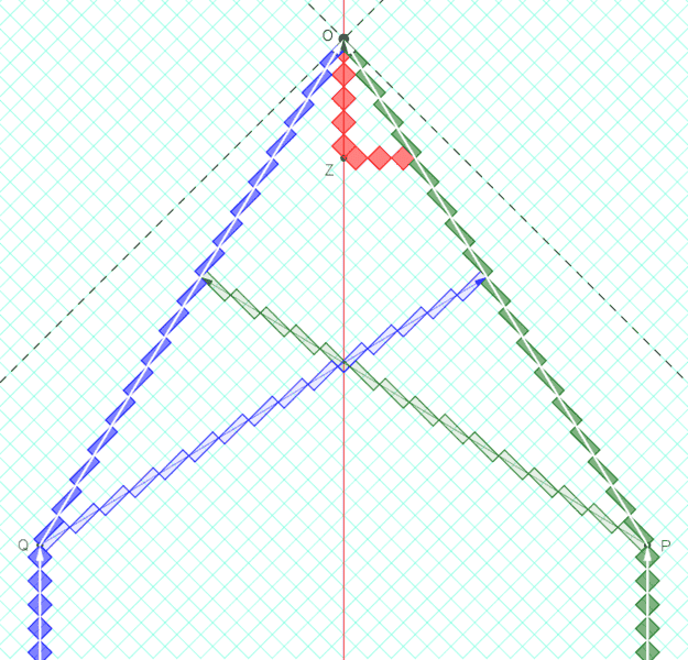

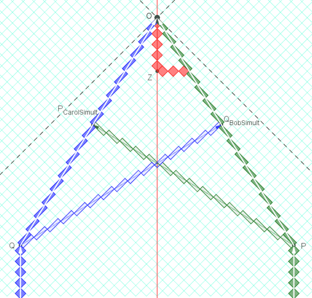

This spacetime diagram on rotated graph paper might help.
To develop physical intuition, we make the arithmetic easier by choosing convenient velocities and displacements so that we can read off calculations by counting.
Here Bob (blue) and Carol (green), starting equidistant in Alice's frame, approach the meeting event O at speed (3/5).
According to Bob, Carol is approaching at (15/17)... since that is [itex]\frac{ (\frac 35)+ (\frac 35)}{1+(\frac 35)(\frac 35)}=\tanh(\rm arctanh(\frac 35)+arctanh(\frac 35))[/itex].
Just after Bob begins his approach at event Q (17 ticks before O on Bob's worldline),
Bob says the event on Carol's worldline just after [itex]Q_{BobSimult}[/itex] (8 ticks before O on Carol's worldline) is simultaneous the event on Bob's worldline just after [itex]Q[/itex], and it is 15 ticks away. (8,15,17 form a Pythagorean triple.)
(Just before Q, Bob accordingly would have identified [itex]P[/itex], which is 25.5=(2*12.75) ticks away. [By similar triangles, 3:4:5 and 12.75:17.00:21.25.]
Assuming a sudden acceleration by Bob, Bob's "spacetime diagram (based on simultaneity)" would develop discontinuities [and, in the other direction, double-counting].)
So, according to Bob, when these final 17 ticks elapses for Bob, only 8 elapses for Alice. Thus, the time dilation factor is 17/8, which is [itex]\frac{1}{\sqrt{1 -(\frac{15}{17})^2}}=\cosh(\rm arctanh(\frac{15}{17}))[/itex]
And Carol measures the same numbers for this identical experiment, as needed by the Principle of Relativity.
If Bob could watch Carol and Alice (because each would broadcast a signal after every tick), everything seems normal but delayed up to event Q.
At event Q, as Bob begins his approach, Bob would see Alice and Carol in fast motion... by a factor of 2 because between each tick of Bob's clock, two of their ticks (following the gridlines) would be received. Think of folks broadcasting one-hour tv show episodes.
(2 is the Doppler factor for 3/5: [itex]\sqrt{\frac{1+\frac 35}{1-\frac 35}}=\exp(\rm arctanh(\frac{3}{5}))[/itex].)
This continues until 4.25=(17/4) ticks before O, when Bob watches Carol move in faster-motion by a factor of 4 because light from event P ( when Carol begins her approach) arrives at Bob's worldline. (4 is the Doppler factor for (15/17). Alice is still at a factor of 2).
[Since Q is not a grid point on the graph paper (at this resolution), study the event 16-ticks-before-O.])
