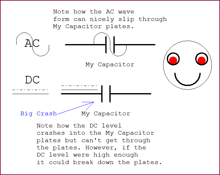

This humorous picture explain how AC current flow through capacitor.
Cartoon diagram comparing AC and DC through a capacitor: an AC sine wave passes between the capacitor plates, while a DC level stops at them, with a smiley face beside.
When we "charge" a conventional metal-plate capacitor, the power supply pushes electrons into one plate, and the fields from these extra electrons reach across the gap between the plates, forcing an equal number of electrons to simultaneously flow out of the other plate and into the power supply.
What happens when all the free electrons have been repelled from the "other" plate :-)

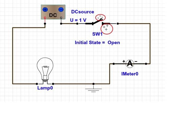

Just wanting to check whether I get the correct concept.
Is it that theoretically, when I connect a circuit like the one shown in below, at the two end of the switch would accumulate some charges, though small, and the ammeter shall read a small current passing through. However this effect can be ignored as the end of switch is so small and narrow that only a very small amount of charge can be stayed at equilibrium state.
Is this guess correct?
This seems an interesting question to think about.
Perhaps the charge on one side would stop accumulating? Due to repulsion?

There might be a small capacitance between the contacts in a switch but for something like a lighting circuit this can usually be ignored.
Sometimes there is more capacitance between the wires on each side of the switch, especially if they are cores in the same cable. If the circuit is AC this capacitance can allow enough power to bypass the switch to light LED lamps. I have this problem in my bathroom. When I changed from halogen to LED lamps I found they were glowing even with the switch off.
