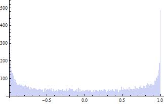

Next I draw a histogram of the oscillator positions at ##t=10##, a time when the system has probably "reached equilibrium":
Code:
Histogram[fun[10], 200]
Histogram of oscillator positions between -1 and 1, with counts high near both ends, peaking sharply at 1, and a flat low plateau across the middle.
The oscillators are most likely to be near points ##x=-1## and ##x=1##, because their speed is lowest near those extrema. One way to quantify the closeness of a microstate to equilibrium would be to somehow compare the distribution of the oscillator locations to this ideal distribution (this would not take into account the momentum distribution, though).
