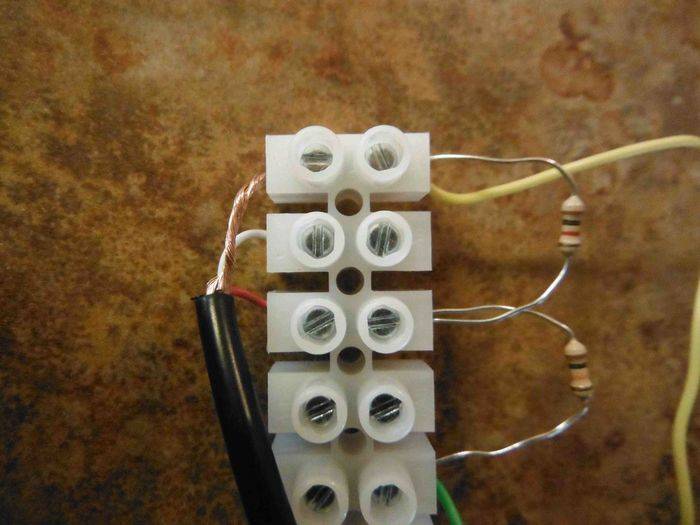

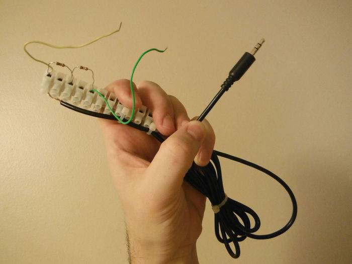

So, first I stripped the stereo extension cable and found 2 wires in a copper sheath (I was expecting 3 wires). The sheath was ground. It was easy to verify the other wire connections to the 3.5 plug using my multimeter.
Instead of soldering immediately, I decided to just build the voltage dividers on my breadboard, so I could play around with resistor values. I wanted to make sure I wasn't going over the limit for my netbook (ASUS 1000he). The other site referenced above by Windadct suggested 0.7 so I went with that. I was using a 9V (which was actually closer to 7V) and so ended up with resistors of 10k and 1k.
I attached the wires from the stereo cable to the voltage dividers on my breadboard using alligator clips. Then for the "probe leads" I just used some jumper wires.

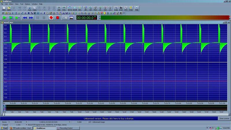

I then built an astable 555 timer leading into an LED. My RC components affecting the flash frequency were 33uF and 10k ohms. I put one lead of the probe next to the anode of the LED and the other on pin 1 of the 555.

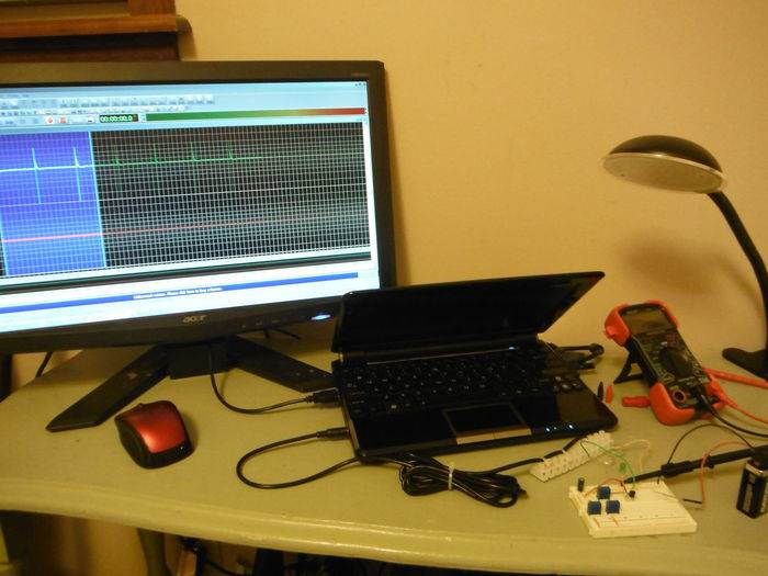

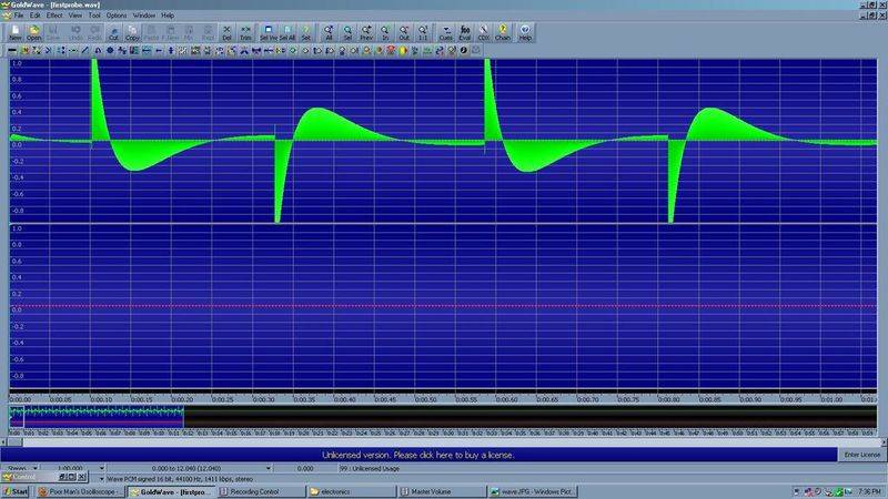

I plugged the stereo cable into my computer and set up goldwave to start recording. As soon as I powered my circuit I got quite a surprise! My computer made the same sound as if I had connected an 8ohm loudspeaker to my circuit where the LED is. That makes sense, but still it was somewhat shocking. This however was with different RC values, when I changed to the ones mentioned above it became inaudible, but I could still hear small clicking that matched my LED lighting.
I printed the screen to show you.
I'm not really sure this is as it should be, especially the huge spikes. My digital multimeter seems to max around 0.5, is it as simple as the vertical axis in goldwave being voltage?
I would be very grateful if someone could build the same circuit and test with a real oscilloscope. I will draw my circuit in circuitlab and post later.
Here is a zoomed in view for a 1 second interval.

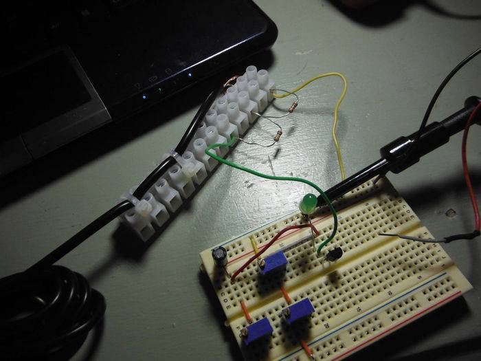

I wanted to share some more if anyone is interested. I moved the probe voltage dividers off the breadboard and onto a terminal block to make it more convenient to use. I'm still hesitant to solder it together because I'm not really sure on the values I'm using, I always check with the multimeter first before slamming it into my computer.
Heres some pics, the circuit is just some potentiometers and a PUT making an LED blink. Goldwave recordings have time stamps so I can see exactly how much is between blinks. The loose grey wire in the second pic is the unconnected positive for the battery.
The yellow is ground and green channel A on the probe. I'm going to put a stranded wire across the terminal strip and do another voltage divider on the opposite side if I ever need channel B.
I'm still not really convinced this is doing what an oscilloscope would. All I can say for sure is that I'm throwing voltage pulses through my soundcard with no noticeable damage to my computer.
Nice job mishma! This is some great hacking. All those plots look AC coupled to me which is why they likely look a little different then what you are expecting. Basically, your "scope" is measuring the derivative of the input signal. I think this is likely because you are using the microphone input. I know the microphone input on my laptop is AC coupled. I suspect yours is as well.
Apparently some laptops have a DC coupling mode on the mic input, like the OLPC kit. So you might check that.

Some questions for you:
You have 2 resistors in series and are calling it a voltage divider. You are then connecting your probe to what I would call the input to the divider? Where is your signal input? As it now stands you could replace the 2 series resisters with 1 equivalent. How familiar are you with voltage dividers?
What is IC2? If I were to attempt to recreate what you have done I need that info.

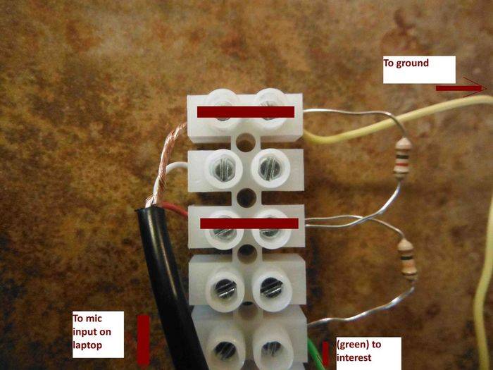

Hi Integral, the resistors aren't in series, although I admit it does appear that way. If you look closely at the second to the last pic, you can see on the left side of my terminal strip there is a copper wire, a white wire, and a red wire in that order leading downwards from the top.
The copper wire goes to ground on the input jack.
The white wire is unconnected right now, but could be used for a second "channel" later. It goes to the middle section of my jack.
The red is connected to the point where the two resistors meet. There is a small cylindrical metal tube stretching across it and you can screw 2 wires in from either side to connect them. So the 2 resistors are connected to the red wire. That's how it makes a voltage divider. Red leads to the tip of the jack and is having its behavior recorded in green in the pics. I will get a better picture of the terminal strip when I get home.
The point of doing a voltage divider at all, as I understand it, is because mic inputs on laptops were only designed to handle 0.7 V or so. So I have to step it down before putting it in. That breadboard circuit is being powered by a 9V battery. I couldn't tell you how a real oscilloscope probe is designed to handle a similar circumstance, I assume the voltage limitation is something ridiculously high.

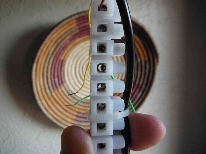

Here's what I was trying to say, Integral: on terminal strips connections aren't only made by putting wires into the same hole, but there is a connection through the strip. So the resistors are in one hole together but there is a third (red wire) that completes the node. On the second image below, red lines are drawn across the strip to indicate connections.

Now, earlier there was the suspicion that my mic port was taking the derivative of the function. So I guess this could be a cos wave? There is a triangle wave generator here in the same book I will try; that should be conclusive.
