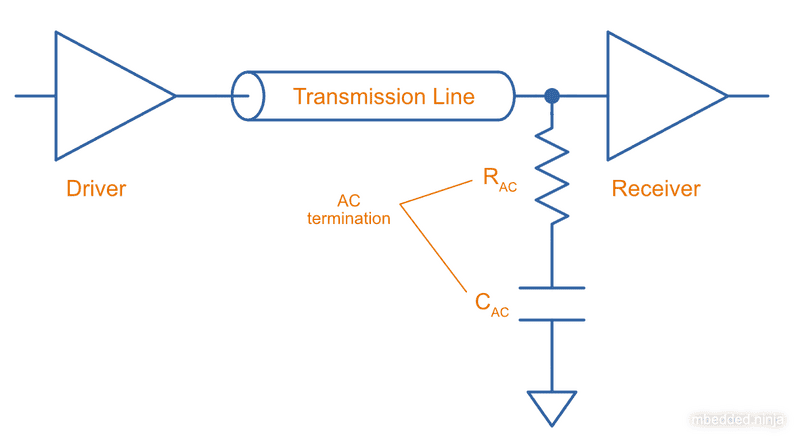

How do we calculate power dissipation for AC termination on a clock signal?
The resistor is dissipating only at the edges(assuming a square wave).
You need to know the clock frequency, the amplitude of the signal, and the capacitance.
Charge is pumped through the resistor with each clock transition.
C = Q / V ; Q = CV .
Q = I t ;
Or you model it with LTspice etc.

If the rise/fall time of the square wave is short compared the the RC time constant, then the energy lost on each edge is the same as the energy change on the capacitor so ##P_d = f C \Delta V^2 ##
https://www.maximintegrated.com/con...snubber-power-loss-estimate-saves-the-day.pdf
PS: This assumes that either the initial voltage or the final voltage is zero. It's really ##P_d = f C |(V_1^2- V_2^2)|##. Again, the energy change in the capacitor is also the energy lost.

Sorry if this question is a bit more on-topic (but not quite), but have any of you used this type of AC termination? I've only used DC forward terminations when the driver can handle the power, and back-terminations when the driver was low power. If I were going to try to use an AC forward termination with a low-power driver, I'd be worried about the complex nature of the termination vs. the real ##Z_0## of the TL. What considerations do you use in sizing the AC termination capacitor?

I guess the point is to save power for low frequency clocks (compared to the transition times)? IDK. That would be the ## RC \gg t_r ## case that I mentioned. Most want to move as much data as possible and they end up staring at curvy lines in eye diagrams.

Yes, I have used it, but only on low frequency, square-wave heartbeat clocks.
Never use it on digital data, RF signals, nor sinusoidal frequency references.
The RC termination is more of a snubber than a line termination. Changing line length in the future, leads to unpredictable results that are hard to identify.

The AC termination is used to terminate DDR4 clock. Other than this, I haven't see AC termination much.
See page 8 of this app note: https://community.nxp.com/pwmxy87654/attachments/pwmxy87654/imx-processors/188384/1/AN5097.pdf
DMM ref designs also have AC termination on the clock.

DaveE, thanks for link and the answer. I was trying to use C*V^2*f and then use 20-30% of the result to account for rise and fall time.
There's also power dissipated by the resistor during this duration, right?

I did use LTspice and learnt how to plot power, which I did not know before.
According to simulation, the Ac termination power is 10x lower than just resistor termination for the same freq, amplitude.

This (my) stuff is all about the power dissipated in the resistor. The power loss in the driver is a much different question. Read through that link again, the RC step response should be pretty straight forward. They talk about modifications if you don't meet my ##RC \gg t_r## assumption.
