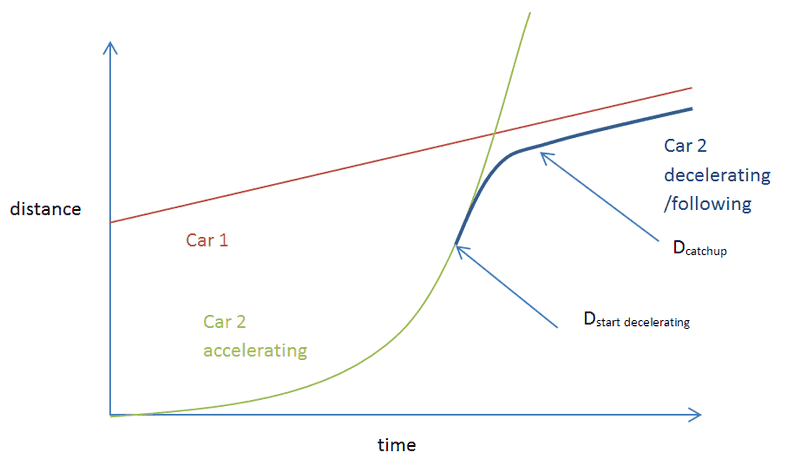

I have the following situation: car 1 is distance di ahead of car 2. Car 1 has either a constant speed v1 or accelerates with a1 (I eventually want to cover both cases). Car 2 accelerates faster than car 1. Car 2 is eventually going to catch up with car 1. I want to calculate the distance that car 2 can accelerate until it has to slow down to reach car 1's speed.
The time/distance graph would look something like this:
d1 = v1 * t + 0.5 * a1 * t2 - di
d2 = v2 * t + 0.5 * a2 * t2
I could calculate the time that it takes for car 2 to catch up with car 1 by combining the two equations above, because when car 2 has caught up to car 1, it will have traveled the same distance as car 1 (plus the initial difference in distance di). So:
v1 * t + 0.5 * a1 * t2 - di = v2 * t + 0.5 * a2 * t2
When solving for t, I think I got the right time for the distances/speeds I put in my example calculation.
However, now I need to determine at what distance car 2 would have to start slowing down in order to not crash into car 1, but line up behind it. I know at what rate car 2 will decelerate, but I don't know from what initial speed vi it will decelerate from (since car 2 is accelerating, this depends on when it starts decelerating), so I can't calculate how far the car will travel when decelerating.
Is there a way to calculate this distance?

I still don't get how I can get rid of some of the unknowns. I updated the graph a little (for my better understanding)
What I managed to caluclate so far is the time/distance where the green line crosses the red line. But that is not of a lot of use to me, because the deceleration would have to take place before car 2 'crashes' into car 1. And the total distance/time until car 2 has reached car 1's speed is more/longer than that.

Taurus, your problem is underdetermined. You have four unknowns, assuming that accel and decel are both constant and Car2 is always either accelerating or decelerating until the catch:
tc: the time of the catch-up
td: the time Car2 switches from accel to decel
a21: the rate of acceleration of Car2 in time 0 to td
a22: the rate of acceleration of Car2 in time td to tc
You have two equations, one to specify the difference in distances traveled at tc is (required) Gap, and one to specify that velocities are equal at tc.
So the problem is underdetermined. You need to specify two more things in order to solve it.
A simple way to get rid of one variable is to require decel to be at same rate as accel, ie a22=-a21.
Having done that, if you now specify the time you want the catch to happen, you are left with two unknowns td (time to start decelerating) and a21 (rate of acceleration). So you can solve the problem.
PS: you can see from your graph that the problem has infinitely many solutions, as the point of inflexion can be anywhere between the start and finish point. The earlier (later) it is, the higher (lower) the initial acceleration and the lower (higher) the deceleration.

##g + h (t_1 + t_2) + \frac{1}{2} i t_1^2 + \frac{1}{2} j t_2^2 = a_1 t_1 t_2##
Is this even the right way? Can I do more? What's the next step?
If you plug in t1 = et2 + f there and sort by powers of t2, the equation should stay within one line. It is not nice, but a computer won't complain calculating it.
An alternative approach:
T=t1+t2 could be interesting. Use it for all places where the sum appears, and use the equations below only in places where it does not appear as sum.
T=t1+t2 = (e+1)t2 + f
For isolated apperances of a time:
t2=T/(e+1)-f
t1=T-t2 = T(e+2)/(e+1)-f
So, just to complete this:
I've got ##g+h(t_1+t_2)+\frac{1}{2}it_1^2+\frac{1}{2}jt_2^2-a_1t_1t_2 = 0## where
##e=\frac{a_2-a_x}{a_x-a_1}##
##f=\frac{v_y-v_x}{a_x-a_1}##
##g=p_x-p_y-d##
##h=v_x-v_y##
##i=a_x-a_1##
##j=a_x-a_2##
Given that
##t_1=e*t_2+f##
by substituting this in the top equation it becomes:
##g+h(et_2+f+t_2)+\frac{1}{2}i(et_2+f)^2+\frac{1}{2}jt_2^2-a_1(et_2+f)t_2 = 0##
Removing the braces:
##g+het_2+hf+ht_2+\frac{1}{2}ie^2t_2^2 + iet_2f + \frac{1}{2}if^2+\frac{1}{2}jt_2^2-a_1et_2^2-a_1eft_2 = 0##
Sorted by exponent of ##t_2##:
##\frac{1}{2}ie^2t_2^2+\frac{1}{2}jt_2^2-a_1et_2^2+het_2+ht_2+iet_2f -a_1eft_2+\frac{1}{2}if^2+hf+g = 0##
All of the ##t_2## separated to bring it into quadratic equation form:
##(\frac{1}{2}ie^2+\frac{1}{2}j-a_1e)t_2^2+(he+h+ief-a_1ef)t_2+(\frac{1}{2}if^2+hf+g) = 0##
Given that ##ax^2+bx+c=0## solved for ##x## is ##x=\frac{-b\pm\sqrt{b^2-4ac}}{2a}##, applied to my equation is:
##t_2=\frac{-(he+h+ief-a_1ef)\pm\sqrt{(he+h+ief-a_1ef)^2-4(\frac{1}{2}ie^2+\frac{1}{2}j-a_1e)(\frac{1}{2}if^2+hf+g)}}{ie^2+j-2a_1e}##
From what I've seen when I put this in my code, it seems to work!
I have a follow up question to the above formulas:
The formula does not work if both accelerations ##a_x## and ##a_1## are 0 (Scenario: car 1 is already at its max speed, and so is car 2. But due to a higher max speed car 2 will eventually catch up and will have to slow down).
In this case, ##e## and ##f## contain divisions by 0. Is there any tweak that can be done to support this scenario? Or would I have to calculate a different formula without ##a_x## and ##a_1##?
If the initial velocity of the second car is faster than the constant velocity of the first car, then we don't have to accelerate at all. Car 2 will have to maintain its maximum speed for some time, which is a new calculation because this cruise time hasn't been considered in the latest approach. It leads to easier equations, however, as you can calculate the deceleration time directly by the ratio of velocity differences and acceleration of car 2. As formula,
$$t_2 = -\frac f e = \frac{v_y-v_x}{-a_2}$$
which avoids the division by zero and replaces the first equation.
