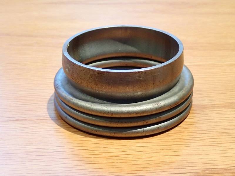

There’s a huge snag here. If the crumple zone and the seatbelt were equivalent to springs, the car would rebound from the wall and the belt would throw the driver back into the seat. Car bodies are specifically designed not to be resilient with a Q factor as low as possible. All energy is dissipated during the crash.
In the end, any object that deforms permanently is still a spring that compresses until the yield point is passed.
And for what it's worth, people (and vehicles) do bounce back in car crashes, with or without restraint systems:

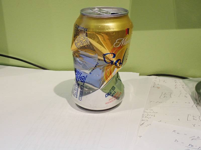

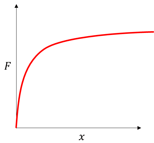

Oh yes that's true over a certain range. But there is no single yield point involved and neither is there an identifiable k value; the Energy is dissipated, not stored because there is (ideally) a minimum of resilience in a crumple zone. Bounce back is just a nuisance for designers (and passengers). Could you suggest what value of spring constant could be applied here?
If a car plunges into a gravel trench at an emergency run-off, there is no identifiable spring-like action; it's just all Energy loss and that's what happens when the mild steel of the car body is deformed. Why should Hooke's Law be involved, particularly?
I would be tempted to model this based on the friction model rather than a spring.

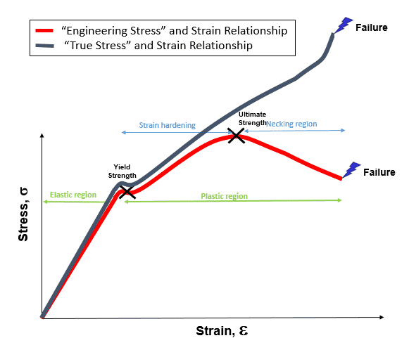

sophiecentaur said:
If you don't absorb it all, the car hasn't stopped moving. Bouncing can happen due to the suspension but have you ever heard of a crumple zone de-crumpling? I can see how you want to use spring constant but the steel is deforming non-elastically all the time. Hooke doesn't consider that.

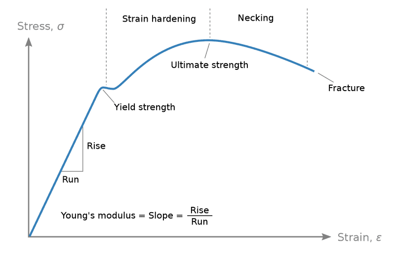

Here's a stress-strain curve:
The first part is the true elastic part. After that, you get permanent plastic deformation until fracture.
But that is based on the original cross-section area, referred to as the engineering stress-strain curve. But in the necking part, the cross-section area is reducing. If you consider this area reduction, you get the true stress-strain curve. The following figure shows the differences:
As you can see, it looks a lot more like a straight line, right up to the fracture, even in the plastic deformation section.
It doesn't really matter that the spring "won't come back" because the energy has been spent instead of stored. What matters is that we can evaluate how much energy it took.

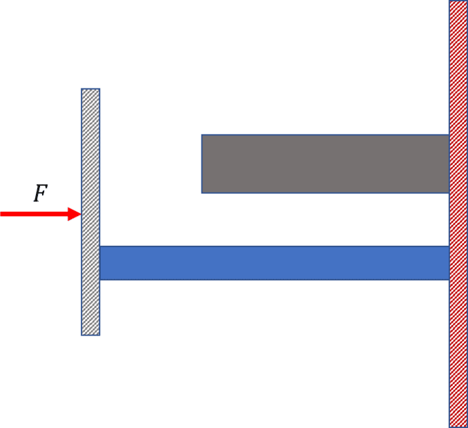

Different parts of the car are compressing during the crash; some are compressing plastically like the crush zones, and others are compressing/deforming elastically and plastically still. The frame, for example, should exhibit some elastic rebound, IMO.

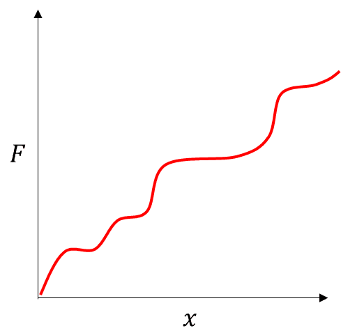

The devil is in the detail here. That graph is for a simple structure. In the case of a car body (which is designed not to behave like a spring) you have a multiplicity of these curves at work - one for each part - with very different vertical scales. You don't need to do any experiments to appreciate what I'm saying - just cast your mind back when you (or a friend) dinked their car against another car or a wall. Even for a very low speed impact, did the car genuinely bounce as a result of making that dent? Even the gentlest nudge will cause (expensive) deformation, showing that the Energy was dissipated by design and not stored. The structure wants to absorb energy.

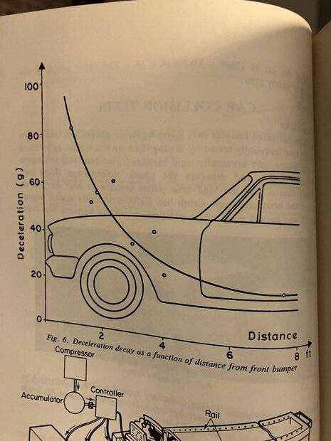

Frabjous said:
Here’s a plot of deceleration as a function of distance. They are designed for <20g for passengers.
But there are two ways of interpreting a deceleration versus distance graph:
1. Peak deceleration for a given crash against distance for the point on the car where acceleration is measured.
This will be a decreasing function of displacement.
2. Current decelleration for the passenger against distance to which the crumple has progressed so far.
This will usually be an increasing function of displacement, though pathological cases could be designed.
It is 2) that we care about for our analysis. It is 1) that the diagram shows.

sophiecentaur said:
Firstly, we are not dealing with a spring.
If so, you would have to identify which body component is 'the spring', with a particular k value.
Almost all the metal material crumpling, acts like a spring until it yields, then it flows under constant force , and new un-crumpled material acts like a spring until it yields etc… this goes on until the energy of the crash has been dissipated as heat.

That may be the case that it was engineered away from what we might expect without design intervention, but trying to understand the un-engineered outcome usually comes first. I don't think anyone was looking for a reliable model (I wasn't), just a way to approach a reasonable upper bound?
Without intervention I would expect something like this, hence the linear spring.

sophiecentaur said:
Have you that evidence that slowly compressing a car against a wall produces a linearly increasing force and elastic deformation?
That was shown in post #12. For sure there is a yield point where if you release the input force the car will regain its original shape. Cars are actually designed that way for low-impact accidents (You'll like that, the car bounces back):
Any solid material has a stiffness with an elastic region and a yield point. A spring is only a special design that lowers substantially the stiffness of the material by playing with geometry. A solid bar is still a very stiff spring.
In the elastic region, the energy is stored and can be fully restored. Once the yield point is passed, the energy is released some other way and cannot be used to restore the original shape - but the amount of energy is still whatever was inputted by way of compressing/extending/twisting the material (stiffness times displacement).
sophiecentaur said:
the very simplest model would consist of many springs with different k's and different lengths, in series and parallel.
Yes, and you could model an equivalent spring from it. The easiest way would be to determine it experimentally by taking measurements while crushing an actual car. Even if one spring breaks before the other - therefore altering the overall stiffness - an "average" stiffness can surely be evaluated for the entire process.
A more complex model would surely involve a damping component, but a very simple model with only a spring should get you somewhere close as I'm not imagining we have an overdamped system by mostly deforming metal.

It dissipates the energy that was first stored before the yield point. There are not really other ways in the case of deforming material. (Well some have a damping effect more pronounced than others.)
Exactly. That force, after the yield point will be dissipating energy throughout the slowing down process. One can either insist that the lost / stored energy is kx2/2 or Fx where F is designed to be a more or less constant force. One is a spring model and the other is a friction model.

You could design in that characteristic but , if you want a more uniform retardation, then it wouldn't be optimal as the high force would be at the end, producing way above retardation. I just don't see why this would be a good car body design.
And Work continues to be done on it. Actually, I think we may be using the term 'yield point' inappropriately. I think we really need it the 'elastic limit', beyond which the material maintains the stress force and, thus, dissipates the energy (similar force over the remanding distance). The fact that steel has a useful non-elastic range makes it very attractive for construction of things like car bodies; it makes small dents easy to repair. Garden tools can still be used, despite having been distorted. That hasn't taken the tool to its yield point - just past its elastic limit.
It's hard to invoke such a simple model as a spring because the dissipative force when a complicated object distorts is nothing like the basic graphs of wires and simple beams. The 'friction' comes from all over, at different times and in different directions.
