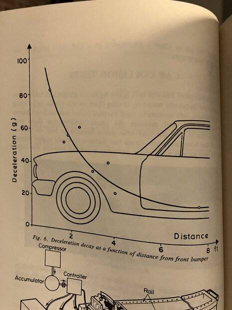

  • #34
As I sort of said in my off-topic deleted post, 20G's is a ballpark desirable max average deceleration for the passenger compartment.
If we use the the equation ##a=v^2/2d## where d is the stopping distance
1) Using 20G for average deceleration, we get an elastic stopping distance of 1.3 cm for a 5 mph collision (assume inelastic deformation starts at 5mph)
2) Using the elastic stopping distance we get
Velocity (mph) Deceleration (G's)
10 39
15 88
20 157
25 245
30 353
35 481
3) If we limit the deceleration to 20G, we get stopping distances for the passenger compartment
Velocity (mph) Stopping Distance (m)
10 .051
15 .115
20 .204
25 .318
30 .458
35 .624
So the designers are probably designing for crushing to go something like this.
Here’s the plot I got the 20G from
