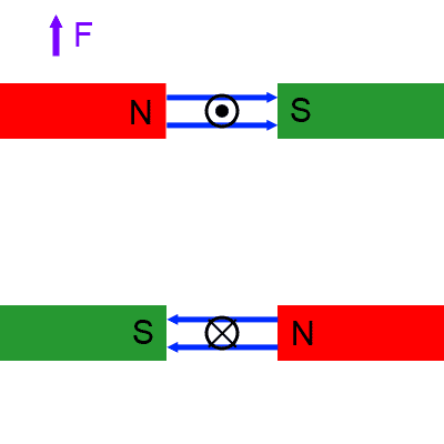

Here is a picture of a situation I thought of:
The circles between the magnets indicate a wire with current flowing in the direction given. This picture is a cross section of a loop of wire, looking down. Not included in this picture is the battery and non-conductive connecting materials linking the magnets and wire together.
Since the current in the wire goes through a magnetic field, it should experience a force in the direction given by the right hand rule. If the magnets and wire are held together, then it seems that the entire system should accelerate as long as the current keeps on flowing.
This seems like a bizarre conclusion, but I can't think of any way to disprove this conclusion.
It will not. The force is from the device back onto itself. Since it isn't exerting a force on anything not part of itself, and it isn't ejecting any mass as propellent, it will not accelerate. It's like connecting a magnet to the end of a stick and holding in front of a wagon, you aren't going to accelerate.
The electromagnetic field can be used to transfer momentum. Could this explain what is happening here?
For example, a solar sail uses momentum from photons (electromagnetic disturbances) to accelerate.
Could this be what is happening here?
Edit: Also what is the source of the force that counteracts the force on the wire? Where is it felt?
There is a force upward on the wire, but there is also a force downward on the magnets. If you imagine the magnetic field lines created by the current in the wire, they are forcing the magnets downward.
Edit: it is an example of equal and opposite forces, as Drakkith was implying.

No, a solar sail works because the Sun has already emitted the light. The recoil from emission is felt on the Sun, and the photons transfer momentum into the sail through absorption and reflection.
On the magnets. The coil feels a force in one direction, and the magnets feel the force in the opposite direction. They cancel out.

magnetic forces always come in equal and opposite pairs, just like gravity and electrostatic forces. It can be less obvious, because often, we don't specify the exact form of the magnet.

Then where is the momentum for the coil coming from? It's got to come from somewhere, it can't just appear. The EM field can transfer momentum but it cannot create it.
Per the third law, the coils feel a force due to the magnetic field of the magnets. In turn the magnets feel a force from the magnetic field of the coil in the opposite direction.
Edit: Whoops, momentum of course can be created, but it is conserved. Not sure what I was thinking here.

Can you explain the force on the magnets in more detail? What is the cause of the force?
The current in the wire creates a magnetic field. This magnetic field causes a force on the magnet.
If you imagine the magnetic field lines from the wire and the magnetic field lines from the magnet, you can see what direction is the force on the wire and on the magnet. (a general quick and easy rule of thumb is that the magnetic field lines like to be as uniform as possible).
for example, on the lower part of your picture, the current is going into the page, so in the space just above the 'north' pole, the magnetic field lines from the magnet are going against the field lines created by the wire. And in the space just below the north pole, the field lines are almost matching up. Therefore, this magnet will be pushed downwards, so that the field lines will become less steeply curved.

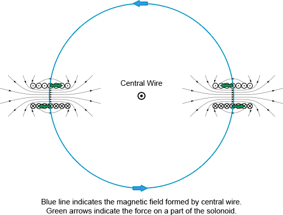

Another way to work it out is if we give our magnets a specific form. For example, the magnets might be made of solenoids. In this case, you can work out the Lorentz force on the charged particles in the wire of the solenoid, and you can work out the force on the 'magnet' (i.e. solenoid), which gives the same answer as the other method.

I took a look at your solenoid example and found that all the forces on the solenoids cancel out. Here is a picture of the top part of the loop. A similar picture can be drawn for the bottom part of the loop.
Edit: The effect is similar to a compass needle aligning with Earth's magnetic field
The green arrows (the force on the wire) is almost horizontal, but not. Because the wire is not exactly horizontal to the central wire, all the green arrows will be pointing downward slightly. This is the force on the magnets.
