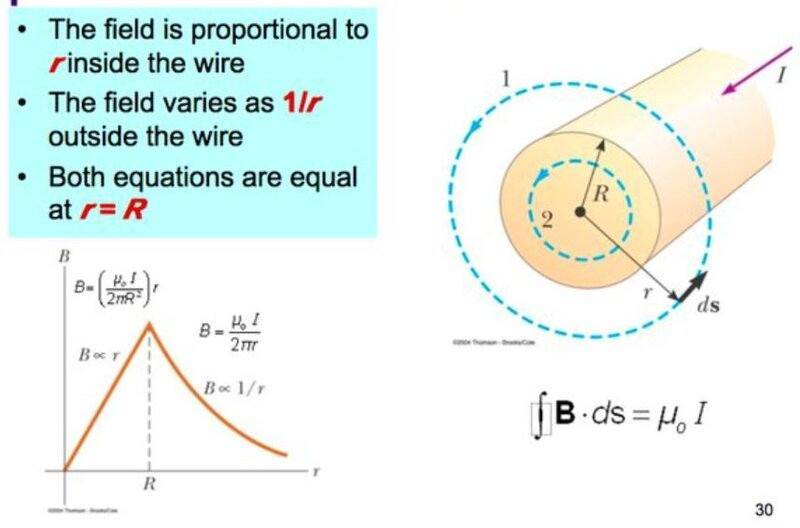

Now, according to ampere law, in the center of a conductor, the magnetic field should be zero.
Therefore, the Poynting vector, equation (2.36), at the center of the conductor will be zero and the divergence of the Poynting vector will also be zero. In conclusion, at the center of the wire, using equation (2.33) the left side equals to zero (del(ExH)=0), but the right side equal to non zero (J dot E = non zero). What am I missing? Thank you for your help!
