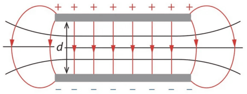

If there are two oppositely charged plates in a vacuum 100 meters from each other, will the electric field intensity in the middle be as intense as the electric field intensity a quarter of the distance from either plate?
Yes, the electric field intensity ##E## is constant throughout the interior region between the plates and away from the edges:
Its value is given by ##E=\frac{\Delta V}{d}##, where ##\Delta V## is the voltage difference between the plates.
Provided the plates are BIG ! :smile:

I believe that is an approximation for when the plates are close together. As the third answer points out (and I quote):
As long as the plates are large compared to their separation, the field in between is roughly uniform, and it will remain so as they move further apart; this means that the force they experience will be the same as you increase the distance. This is not intuitive until you realize that most of the plate "might as well be infinite" as seen from a point charge on the opposite plate. It's only when the angle subtended by the plate becomes "noticeably less than" 2π that you start to see a drop off of force - as you said, the lines of the E field will start to bulge out. Another way to look at this is with a simple Gaussian pill box around the plate: the flux through the surface depends only on the charge in the box, which doesn't change.

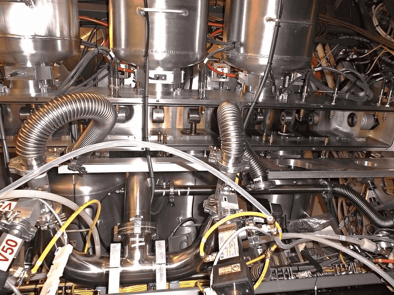

We do.

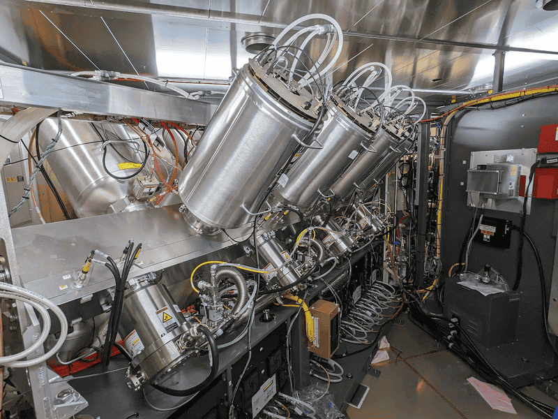

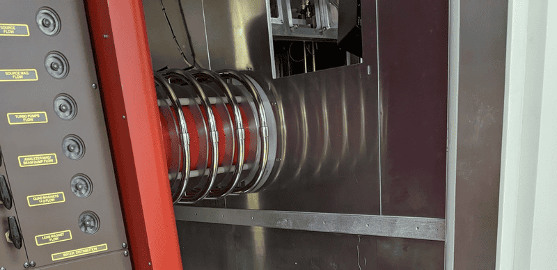

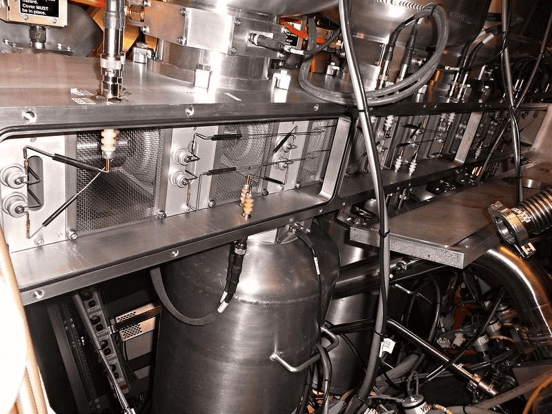

This is a linear accel (500 keV) tube on a industrial accelerator (ion implanter for semiconductors) with electric field equalization (high resistance, high voltage voltage divider resistors between plates) plates.

So those rings in the middle don't have alternating electric fields?

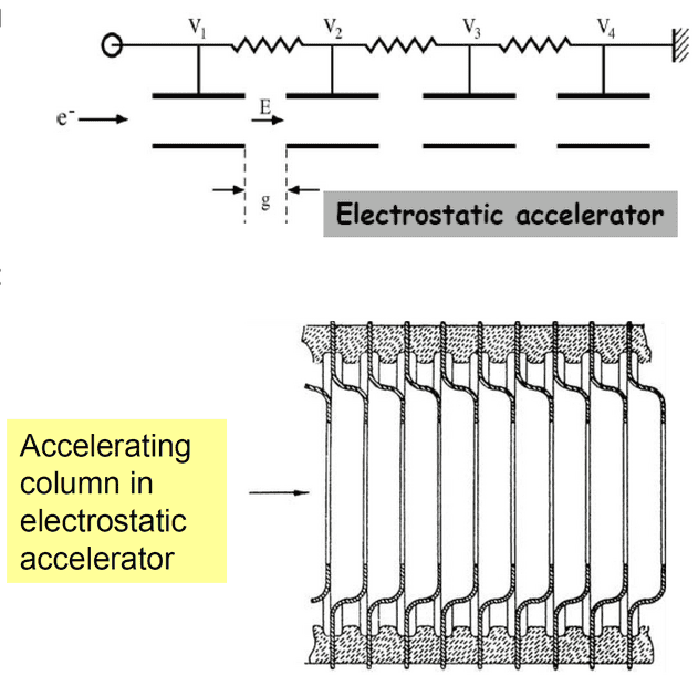

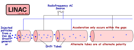

The ion column for implantation in that picture is presumably an electrostatic accelerator, which uses only DC voltage (https://uspas.fnal.gov/materials/14Knoxville/Lecture2_Particle_Acceleration_1.pdf):

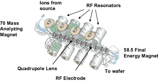

But AC can be utilized instead to achieve higher beam energy with a linac (https://www.cyberphysics.co.uk/topics/atomic/Accelerators/LINAC/Linac.htm):
Google the italicized terms above as well as linear particle accelerator for more reading.
