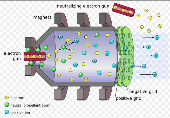

Yeah exactly. The use case I am picturing is for Ion drives in spacecraft , see attached image.
The energy is imparted into the ions via the accelerator grid (parallel plates separated by insulating layer), so the plates must loose energy somehow, right? And the way parallel plates store energy is through their electric field (E=1/2 * C * V^2). So the voltage must somehow be reduced between the plates (since the capacitance would remain constant) and I am struggling to see how this can occur if the plates are electrically isolated from one another.

If PeroK is correct, could one not simply place a pair of charged plates on a spacecraft and accelerate all the fuel reserves for free (never needing to recharge the plates) since the electric field between the plates would never loose energy since the plates would not exchange charge? This seems like a free energy kind of situation to me, hence why I'm struggling to see how this would be the case.
  • Cutaway diagram of a gridded ion thruster: electrons from an electron gun ionise neutral propellant atoms in a discharge chamber, ring magnets surround the chamber, and a double grid with negative and positive grids accelerates the positive ions out, while a neutralizing electron gun emits electrons into the exhaust.

Except that a) you need fuel to fire the protons at whatever speed you are proposing in the first place; b) the ejected particles are only gaining KE from PE they had initially relative to the capacitor.

You can't accelerate charges that way. What is the electric field everywhere but between the plates? How do you accelerate the proton to get it between the plates where there is an electric field? How do you keep the negative electric charge from building up on the ship as you remove positive charges?

An ion thruster only works when one enforces the injection of “neutralizing” electrons into the emitting ion beam. It is thus the power supply of the neutralizer which delivers the energy necessary for the propulsion.
