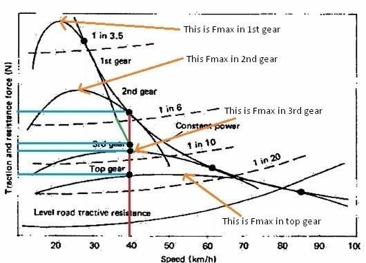

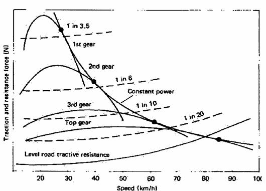

  • #46
Dale said:
Not at rest. From a stand-still power is 0 regardless of acceleration.
Yes, but acceleration from a standstill is a very small subset of the "how fast will my car accelerate" case, and is complicated by a number of other factors.
Dale said:
But the alternative leads to misconceptions on the physics as demonstrated by the OP. Here I am concerned about fostering correct physics much more than fostering correct purchasing decisions.
I feel like the constant "no, power doesn't determine acceleration" in this thread is leading to far more misconceptions about physics than my statement above. In addition, knowing that it's proportional to power is fundamentally more useful, since a car's power is easily determined from its specifications and is independent of things such as driveline configuration and gear ratio. It's much simpler for a driver to know that to maximize acceleration, they must simply select whatever gear puts the engine closest to max power rather than suggesting that they must calculate wheel torque based on varying gear ratios and engine RPM.
For an example of how this can be misleading, you very confidently stated that the statement in the video in post #8 was wrong. You are wrong about this. The video is absolutely correct. At best, your statement is extremely misleading, since the video was quite clear about its statement that horsepower determines rate of acceleration (correct), and acceleration determines the reaction force between you and the seat of the car (also correct).
Fact: At all nonzero speeds, acceleration is directly proportional to power to weight ratio, and inversely proportional to speed

jack action said:
I see the problem now from your perspective. So you are unfamiliar with the problem and don't see how it is to "teach" a «torque» person about the importance of power in vehicle acceleration? Let me get you up to speed with this thread. The fun starts with post #15 with OldYat47 (and, yes, it goes all the way to post #100). This type of discussion has been going on forever in the automotive community and the web forums are filled with those. You might appreciate more why you must be careful about the wording you choose when entering this debate.
Huh. I'd forgotten about that thread. I was expecting this one

I really like this plot you posted in that thread:
jack action said:
Note that there is one unique point of peak wheel torque corresponding to the one unique peak acceleration. There are four points of peak power, none of which are the peak acceleration.
Any justification you can give as to why power should be considered as being proportional to acceleration are just torque expressed in terms of power. In any way that wheel torque differs from power, acceleration follows torque not power.
Sadly, it is not the "peak" wheel torque. It is in that gear ratio. You could have a lower gear ratio and get a higher peak wheel torque. Even at that same exact velocity, you can reach a higher wheel torque - the highest possible - which, guess what, correspond to the peak wheel power! (more details in this post)
This particular example has different gear ratios. But what if you want to compare an electric motor with a combustion engine? Or even if you want to verify a claim from someone presenting a new kind of motor? Which one has more potential to give the largest acceleration over a given speed range? It's the maximum power output you can maintain in that speed range that really tells everything you need to know. The only way it wouldn't matter is if you power a vehicle with something like gravity, where the force is constant and not limited power-wise. Although, note-worthy, it is a very unusual case that doesn't relate to most machines we know, especially cars. When someone ask about cars, I don't think assuming a power-limited machine is too big of an assumption.
The real "torque vs power" problem is «Should you maintain your engine at peak torque or at peak power to get the maximum acceleration throughout a given speed range?» The answer to that question should be unequivocally "peak power". For some unknown reasons, there are still people claiming "peak torque", mostly because ##F = ma## and there is no power in that equation.
But that vehicle does not have a lower gear. For that vehicle that is the peak torque and the peak acceleration occurs at the peak torque not at peak power.
This is your own example, surely you don’t think it is a bad or unrealistic example. So then, without changing the configuration, just looking at that plot as is, where does the peak acceleration occur? Is it at the peak torque or the peak power? If it is at peak power then which of the four peak power points has the highest acceleration and why?
Do you believe that in all engines the peak power occurs at the same point as the peak wheel torque? If not, then for those engines does peak acceleration occur at peak torque or at peak power?
Yes, that is the one with the largest potential acceleration. And which one has the largest actual acceleration? It is the one with the largest wheel torque.
