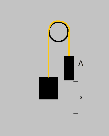

Okay, so comparing my previous image to the one below:
Diagram of an Atwood-style pulley: a yellow string runs over a pulley, with a block labeled A on the right and a larger unlabeled black block on the left, and a bracket marked s beside block A showing its displacement.
Here, gravity's pull on A (again, like you did, assuming that A's mass is greater than that of the unlabeled), displacing A the distance s, will do the same to the unlabeled weight. In the previous image, displacing A by s, would displace the weight by 2 times s (?). I assume it is harder to displace A in the previous image, then, seeing as the work done by gravity is double there?
Is the same. "mgh" is "mgh" regardless of how the pulley, ropes, are rigged. The length of rope you've got to move past a particular point to lift/lower "A" a distance "h" can be changed, and the force you have to apply to pull the rope can be many times greater or less depending on how much mechanical advantage you "rig" into the block(s) and tackle.
