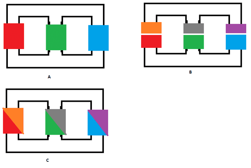

I brought up Bifilar because I wanted to in a way use it as a comparison standard between coil magnetic couplings, as it is the best possible.
As I said, I wanted a bit of a general sense of how effective various winding arrangements are. Something I should have done in the first instance, here is an illustration for your comparison:
Keeping in mind that each coil is linked to each other coil because they're all on the same core.
A) -> Comparison of coils on adjacent limbs: Imagine that each colour has HV and LV windings. What would the mutual coupling between, say, red and green primaries, or red and blue primaries, be?
A) -> Comparison of coils on same core: say that there are HV and LV coils comprising each red, green and blue. What would the mutual coupling the HV and LV red coils be?
B) Comparison of coils on the same core: Say red is the primary, and orange is the secondary winding, green is the primary winding, grey is the secondary winding etc. What would the coupling of the Red to orange coils be? Similarly, what would the coupling of the Red to grey, red to green, be?
C) Red is wound bifilar with orange, etc: what is the coupling of red to orange, what is the coupling of red to green?I hope this clarifies my original line of inquiry.
Thanks
You worked that years ago in your magamp thread.
The magnetic circuit apportions flux according to the mmf(amp-turns) in each leg. It's a circuit that you solve with mmf's and reluctances.
There must be differences in leakeage fluxes between the three winding types. Also:
If I were to treat this like a simple NI -- reluctance circuit, then would not: each of the A), B) and C) all have the same coil coupling relationships, comparatively? Because certainly bifilar winding, is has far superior coupling to that of B) where the primary and secondary are on the same limb, but occupying different parts of it.
Note: there are primary and secondary coils in A) but you can't see them because the outer RED coil obscures the ORANGE secondary coil underneath.
As per my last post, I have my own personal expectations of what the coupling order of best to worst would be. [For example, I expect bifilar coils wound on the same section of core like red to orange as in C), would have better coupling to that of the HV/LV (primary/secondary) coils in A), which itself would have better coupling of red to orange than in C), which would have the poorest coupling]. But there are a couple of things I don't understand, for instance:
When you have a better coupling of primary to secondary on the same limb (like in the case of bifilar) is there also an impact on the other coils on the other limbs, like coupling between adjacent limb primary-primary coils gets worse? This is to say, would the coupling of the red to green primaries, be the same for B) as they would for C)? After all, the magnetic path hasn't changed, just the winding geometry. Or has improving the coupling of red to orange between those coils also decreased the coupling of red to green? etc.
[That flux generated by red passes through orange, then it passes through grey/green and purple/blue, but if you've improved the way it couples through orange, does this also effect how well it passes through grey/green and purple/blue, or can you have your cake and eat it too. If so, as long as the insulation was high enough, bifilar would be win-win]

jim hardy said:
You posited single phase.
Regarding the A), B), C) illustration, single or three phase doesn't matter, at this point I'm just trying to step-wise discuss if there are any differences in leakage flux and mutual coupling between windings on the same limb or adjacent limbs.

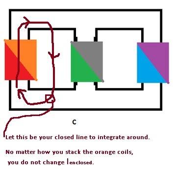

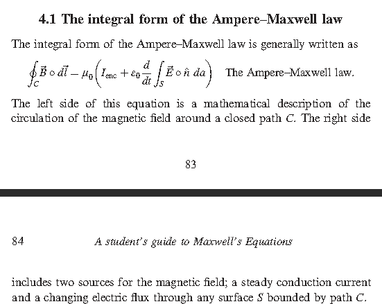

tim9000 said:
Can you elaborate on that? :p
Back to the basics ?
https://www.princeton.edu/ssp/josep...ide-to-maxwells-equations-D.-FleischLEISC.pdf
which my undergrad course instructor simplified to
Closed loop Integral around any closed line path of MMF dot dlength equals the current enclosed .
°∫ H dl = Ienclosed
Ienclosed is of course amp-turns..
Applying that,
so MMF is not changed by rearranging the coils.

Ah geez, I did know how to derive all of Maxwell's laws once. I don't have my formula exercise book on me at present.
It's the right hand side I'm hazy on: was it something like all the electric charge that moves due to the magnetic field on the surface cancels out due to symmetry or something, so it's zero?
As per your previous post, if I'm not mistaken lenclosed is zero, because no H is enclosed, because H is parallel to the plane of the loop. However, if the lenclosed was on the same plane as the coil turns Ienclosed would be the integral of the flux.
I think this is too crude a method of analysis to use Ampere's law precisely due to one of the factors I'm trying to examine, namely leakage flux.

tim9000 said:
However, for example I'm highly skeptical that the amount of flux that flow from red to orange will be the same in B) as it is in C). (Due to a poorer coupling than when bifilar).
You asked about coupling between windings on different limbs.
Now you're talking about windings on the same limb.
Sorry, ten day late reply.
jim hardy said:
Now you've changed the question.
Actually, I attempted to communicate that the question was always how the flux would vary between coils on the same limb and on adjacent limbs.
tim9000 said:
A) -> Comparison of coils on adjacent limbs...
So, I think thus far we clarified that the flux between adjacent limbs would be the same relative in either A), B) or C).
But that there would be differing leakage flux between coils on the same limb relative to the A), B) or C) winding arrangement. Thus, I would conclude that this amount of leakage flux doesn't impact the coupling between limbs, just merely coils on the same limb, which is where the advantage lies.
Did anyone know roughly how much of an impact these A, B and C variations would have to the mutual coupling coefficients in this regard?
Cheers

tim9000 said:
conceivably the coupling to adjacent limb coils is the same throughout A) B) & C) are the same because the respective leakage flux doesn't change throughout the three arrangements(?) But that's what I'm seeking clarity for.
I believe that would be so.

Hi Jim,
thanks for the reply, great, so I can put this to bed concluding: The amount of leakage flux on the same limb can vary depending on the winding arrangement, but the amount of flux coupling between adjacent limbs will be the same regardless of winding arrangement.
If I may 'pivot' this thread slightly; regarding the real transformer model:

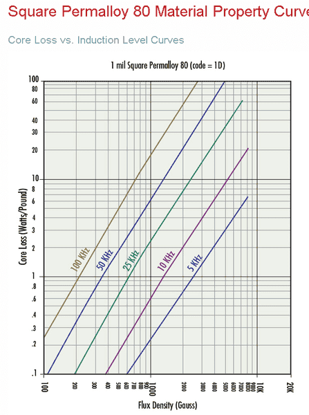

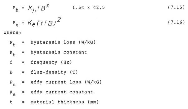

I wish I understood Steinmetz's equation better. So from what I gather, it's more about observation rather than most base level scientific explanation.
I didn't consider the core Xm would have one impedance to the fundamental and another to the 3rd harmonic, so there you go, I learned something. It would be better in that regard.
So is that Steinmetz power equation specifically related to heat and magneto-striction?
But I'm still confused, isn't core loss based on Rc which will be lower the larger the core is?
of course.
P = E2/Rc
If you operate a larger core at same flux density that's same loss per pound in more pounds so loss will go up. But larger core at same flux density is more flux hence more volts per turn.
If you operate that same larger core at same total flux to give same volts per turn, that's less flux density so loss per pound goes down.
