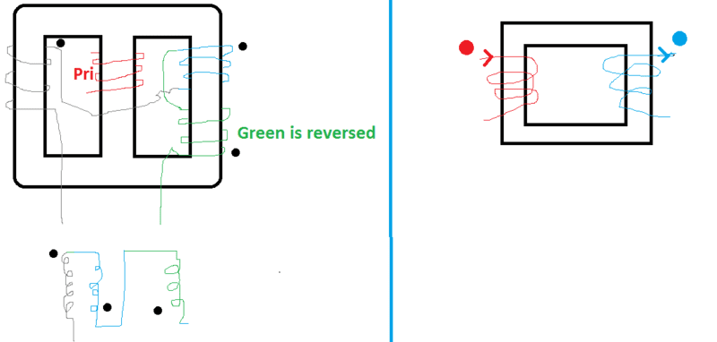

Hi,
I have a couple of questions regarding re-wiring a three phase transformer.
Say you have a three phase TX with a ratio of 415:22 and you want to use it as a single phase step-up TX (excite it with a variac or something), this is a thought-experiment.
If you excited only the middle leg of the many turn side (leaving the other two outer 415 coils open), and series-ed up the outer two legs of the 22 coils, as in the RHS of the picture, you would have Φ flux equally through each secondary, so it'd be a 415:44. (Because you left the middle 22 coil open). However, if you also series-ed up the middle leg secondary in reverse (compared to the outer two, as in the LHS of the picture), because it has 2xΦ flux as the outer two, I assume it would have double the voltage. So what would the resulting turns ratio be? 415:66? Or 415:88?
My second question is about the mutual coupling coefficient, between all the coils on a TX core, single or three phase, does this 'M' have to equal a total maximum of '1' between all the coils? That is to say, even if you have multiple identical coils on the same core, coupled well, between any two the coupling is only at most 0.5? For example on a three phase core, the middle coil will link to the other two 0.5 each.
And a side question about this, is that if you were actually looking at the coupling of one limb to another, given that the coils are not wound one on top of the other on the same limb. The flux has to travel through the core to it. How much less will the coupling coefficient be, compared to if the coils were both wound over each-other (say, bifilar) on the same limb? (How much increased leakage flux, very generally speaking.)
Thanks very much

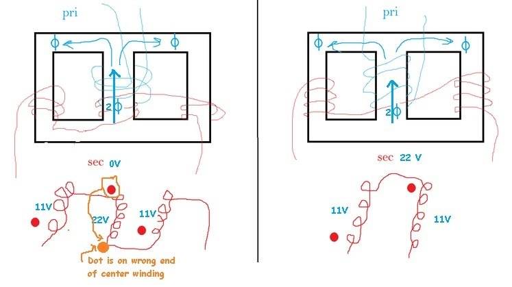

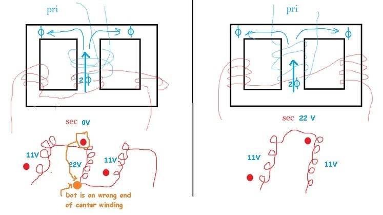

It'd be a 415::22 . Each outer 44 volt winding has half flux so makes only 11 volts.
As you drew it it'd be 415::0 . That's because, if you look at direction you connected them, center is in series opposing not aiding the outer two. Flux goes UP it and DOWN the others. Your dot is on wrong end.
If you swap ends so it's in series aiding you'll get 415::44.
jim hardy said:
It'd be a 415::22 . Each outer 44 volt winding has half flux so makes only 11 volts. View attachment 206518
Hah! you're right, one 415 Φ through a 22 coil would only be 11V, so yeah, 22V secondary.
Yes, you're right that the middle limb flux is going up, while the outer limb fluxes are going down. I did know that and I meant to draw the coil winding itself reversed on that limb of the core diagram. That's why I drew the dot on the top for that one. But I see I made a mistake. Assuming that the middle limb coil is connected opposite to the outer coils, and given the above quote, wouldn't it be 415:44 as you say?
But how is the dot on the electrical diagram drawn the wrong way?Thanks Jim!

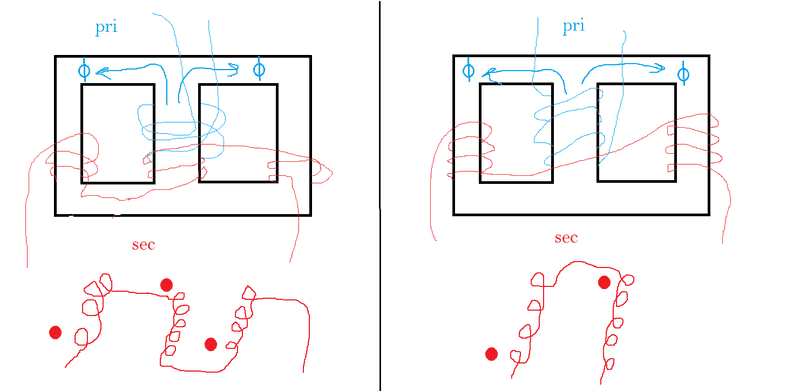

well, look how you drew the dots they're in series aiding
your schematic drawing shows most of them upside down from your physical drawing adding to the confusion
assume a current direction and do right hand rule, one aids flux while others oppose it, or vice versa
Ah, I think I see what my issue was. I should have reversed the winding, which keeps the dot the same as the others, rather than reversing the dot.
So an analogy would be like this:
(*attached*)
Well , depends on whether you want consistency in your drawing between directions indicated for windings and dots and polarities.
Being consistent helps our thinking.
