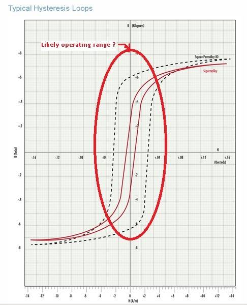

I was having another think today about Rc and B, and how increasing the core cross sectional area and volume, could reduce losses when it would seem that Rc should go up.
I still don't quite understand it but I'm thinking (without evidence) that maybe (I say cautiously because I know you can't speculate on PF) that the losses are based from more than just Rc?
See, I was thinking core losses would be simply IRC2*Rc
However, maybe it's a combination of this AND the B1.6 ??
Because that way losses could be based off Rc which would go down (so IRC would go up, and consequently it's contribution to power) but B might decrease by a factor of more than 1.6, so the total loss actually goes down?
Please let me know if there is some formula or explanation I'm missing.
Thanks
  • #33
Steinmetz's original paper is out here someplace on internet, i found it once and linked to it.
Think about it.
The transformer equivalent circuit is a math model describing the physics not the actiual physics itself. We can refine it ad infinitum.
Iron loss depends on how hard you push the core and it's not linear . It's B^1.4 or 1.6 or something.
You know if you double volts per turn you double flux. If you halve one you halve the other.
(1/2)^1.6 = 0.32
In the transformer model
P = E2/Rcore
Halving volts quarters the right side but only lowers P by 0.32 not 0.25 .
Rcore = E2 / P
So R has to change.
I'm sure you can work out a R vs E relation using logarithms but that makes equations not intuitive-at-a-glance for me. I have to work first in simple arithmetic then build toward elegance. I expect a roughly square root relation because in dividing you subtract exponents and 2 - 1.6 = 0.4 .
Appreciate any corrections - did i make a thought blooper ?

Thanks Jim,
Yes, if you either halve the volts/turn or double the area of the core, B is halved.
I found this:
Which gives a better explanation than what I saw earlier (more easy for me to digest), what do you think of this? It doesn't have the 1.4 or 1.6, do you suppose they just rounded it up to 2?
I assume the Pcore = Peddy + Physteresis ?
So I was thinking that a manufacturer would give you a 'watts / pound' for your steel sheet, (that this would be related to RC and that the more steel you used, the more watts / pound the core would be consuming. Would the eddy current constant Ke basically just be the conductivity of the steel and the cross-sectional area of the core?
(Sorry, I'm writing this reply very rushed)
Cheers

  • #38
tim9000 said:
Presumably RC will depend on what B is?
Because, I'd have thought that rather than all this curve fitting stuff, you'd just do a Open Circuit test, find RC, then approximate what your losses would be based on how much magnetising current was going through RC for your secondary load current...?...No?
Yep. Doesn't open circuit test establish approximate operating B ? Hence approximate losses in that operating region ?
It's just a math model. One can refine it forever, least squares fit Rc to B and write in the equation . Maybe for a thesis or something but it wouldn't make sense for everyday maintenance work i did all those years.. unless you had some unusual application that overworked the core. We once had some transformers melt from third harmonic current but that was overworking the copper not the iron. Took a while to figure that one out.
old jim

tim9000 said:
However, if you hold N.I and increase the core cross-sectional Area, then doesn't B stay the same? Because, flux = MMF/Reluctance, and Reluctance = length/(Area.Permeability)
That is the distinction I was confirming.
because flux = B.Area
Yes ! You answered your question yourself - I knew you already knew that - thanks !
tim9000 said:
However, if you control N.I to keep it constant, and increase A the flux will increase and B will stay the same.
is the 'what'
just wanted to hear you say the 'why' behind it.
Ya done good, friend ..
