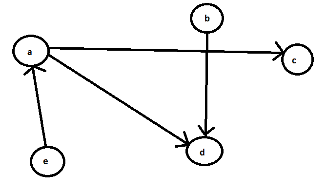

Suppose that we have a DAG and want to find algorithmically all its possible topological sortings.
I found this program at page 6: http://www.cs.ncl.ac.uk/publications/trs/papers/61.pdf, but I haven't really understood it.
Could you explain me the general idea?
How would it work for example if we had the following graph?View attachment 4228

Also I thought that we could also find all the possible sortings with an adjacency matrix.
I have thought of the following algorithm:Let $S$ be the set of the starting nodes.
Code:
while (S!=empty set){
         pick a node q from S
         Alg(q)
Code:
Alg(q){
     for i=1 to |V|{
          if A(q,i)==1{ // A is the adjacency matrix
             A(q,i)=0
             Enqueue(Q,q)
             Alg(i)
     Dequeue(Q)
Is the general idea right? If so what could I improve at the algorithm? (Thinking)
I don't know about that paper, but I have an idea how to do it. (Thinking)
Suppose we repeatedly run through the nodes and pick the first node that has all incoming dependencies satisfied.
We'll append that to an output list that is initially empty.
In the first run nodes b and e are the only nodes that have no arrows pointing to them.
So we pick b as the first node and get the output list (b).
In the second run e is the only node available, yielding (b, e).
In the third run a has become available, since its dependency on e is now satisfied.
So we get (b, e, a).
Next is c. And finally we get to d.
So our list has become (b, e, a, c, d). (Happy)

evinda said:
To do this, could we use the adjacency matrix as I did in post #2? (Thinking)
Let's see... (Thinking)
First node we might pick is q=a.
So we would execute Alg(a).
Searching the adjacency matrix, we find that a is connected to c.
So we remove that connection, we enqueue a, and continue with Alg(c).
But... node a is not suitable to select as first node. :eek:
I think I don't understand your algorithm.
Can you clarify? (Wondering)

$S$ is the set of starting nodes, that means it contains all the vertices with no incoming edges. So $a$ cannot be selected as first node. (Thinking)
Can you run through your algorithm then and explain how the nodes get processed? (Wondering)

I changed a little the algorithm.
Code:
S: set of starting nodes
L: output set
while (S != empty)
     pick a node q and delete it from S
     Alg(q)k=0;
Alg(q){
     add q into L
     for i=1 to |V| {
          if (A(q,i)==1){
               A(q,i)=0
               for j=1 to |V| {
                    if (A(j,i)==1)
                        k=k+1;
               if (k==|V|)
                    add i to S
               Alg(i)
At the beginning we have $S=\{b,e\}$. We pick $q=b$, delete it from $S$, so $S=\{e\}$.
We call [m]Alg(b)[/m] and we add $b$ into $L$, so $L=\{b\}$.
[m]A(b,d)==1[/m]
We set [m]A(b,d)=0[/m], $d$ has still incoming edges so we don't add it into $S$.
We call [m]Alg(d)[/m] and we add $d$ into $L$, so $L=\{b,d\}$.
The condition [m]A(d,i)[/m] is never satisfied so we go back at the while-loop.
We pick $q=e$, delete it from $S$, so $S=\{ \}$.
We call [m]Alg(e)[/m] and we add $e$ into $L$, so $L=\{b,d,e\}$.
[m]A(e,a)==1[/m]
We set [m]A(e,a)=0[/m], $a$ has no incoming edges so we add it into $S$, so $S=\{a\}$.
We call [m]Alg(a)[/m] and we add $a$ into $L$, so $L=\{b,d,e,a\}$.
[m]A(a,c)==1[/m]
We set [m]A(a,c)=0[/m], $c$ has no incoming edges so we add it into $S$, so $S=\{c\}$.
We call [m]Alg(c)[/m] and we add $c$ into $L$, so $L=\{b,d,e,a,c\}$.
The condition [m]A(c,i)[/m] is never satisfied so we go back at the while-loop and since $S$ is empty, we have finished.
Is it right? (Thinking)
But...can we find in that way all the possible topological sortings or only one? (Thinking)

But at the output set, node $d$ is missing. Have I done something wrong? (Thinking)
When you select q=a, not only node c is added to S, but node d should also be added to S. (Wasntme)
I tried it again...
The set of starting nodes is: $S=\{b,e\}$.
The output set is $L=\{ \}$.

Do we get the same result? Or have I set the wrong values at [m]S[/m], [m]L[/m], [m]A[/m] ? (Thinking)
First node d was selected from S={d}.
After that, all selections from S={d} were complete.
Node d should not be selected a second time from the same S={d}. (Wasntme)
So which should be the values of [m] S, L , A [/m] after the output [m]L={b,e,a,c,d}[/m]? :confused:
After that we first go back to S={d} and L={b,e,a,c}.
And since we've gone through all choices in S, we backtrack to S={c,d} and L={b,e,a}. (Thinking)
We've already had choice c, so the next choice from S is node d.
So we recurse and get to S={c} and L={b,e,a,d}.
And then we get to S={} and L={b,e,a,d,c}, which is the next solution. (Mmm)

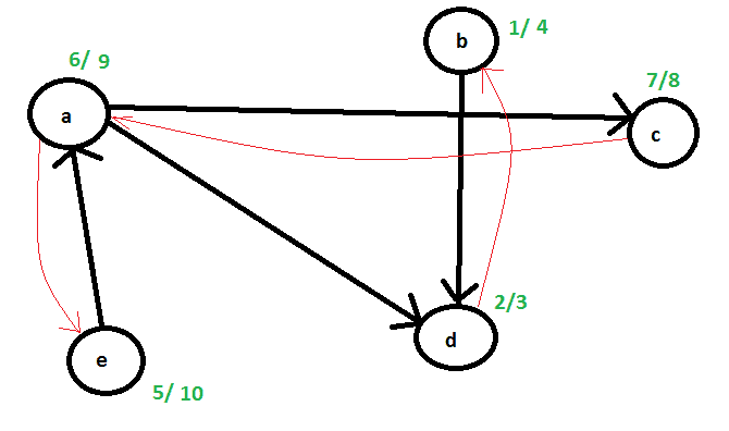

  • #32
Wouldn't that algorithm return just 1 solution? (Wondering)
  • #33
Yes, it would.. But DFS doesn't always return the same result. If we apply for example twice the DFS at a graph and at one step, there are two different nodes to visit, we can once visit firstly the first node and the second time when we apply the algorithm we would visit firstly the second node and so the results would be different, since the finishing times would be different.For example if we have this graph:View attachment 4263
applying DFS we could get these discovery and finishing times:View attachment 4264these ones:View attachment 4265
or these ones:
View attachment 4266So at the first case, the result of the topological sorting would be: {b, e, a, d, c}, at the second case the result would be: { b, e, a, c, d} and at the third case: {e, a, c, b, d}.How could an algorithm return all these possible results of topological sorting?
  • #34
I don't understand. (Sweating)
What do your arrows and your numbers mean? (Wondering)
  • #35
The numbers respresent the discovery and finishing times. The arrows show from which node we came to the current one.I applied only DFS, starting with the nodes that have no incoming edges. (Tmi)
Now I got the following topological sortings:
[m] {e, b, a, d, c}, {b, a, a, d, c}, {b, e, a, c, d}, {e, b, a, c, d}, {e, a, c, b, d}, {e, a, b, d, c}[/m]
But I haven't found the topological sorting [m] {e, a, b, c, d}[/m].. How do we get it? (Thinking)
To find this, we should start from the node [m]d [/m], or not?

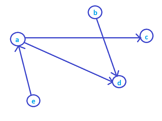

  • #36
What are "discovery and finishing times"? (Wondering)
It's a variant of [m]{e, a, b, d, c}[/m] where only the last 2 nodes are swapped around, which has no impact on the topological ordering. How is it that you did not find it? (Wondering)

  • #39
So even if we want to find a topological sort, can we visit at each step any node, even if it has incoming edges?
Because in this case, we also get the output {e, a, b, d, c}... :confused:
  • #40
evinda said:
The DFS procedure takes as input a graph $G$, and outputs its predecessor subgraph in the form of a depth-first forest. In addition, it assigns two timestamps to each vertex: discovery and finishing time.
Ah! That explains it. (Mmm)
evinda said:
I think that we do not get it, applying all possible DFS. Or have I done maybe something wrong? :confused:
Your DFS algorithm appears to finish each subtree before moving on to the next subtree.
However, that is not a requirement for a topological ordering.
So you're missing out on some topological orderings. (Thinking)
Yes, we can visit any node in each step.
And yes, that node can have incoming edges, as long as all its predecessors are already in the current topological ordering. (Wasntme)
