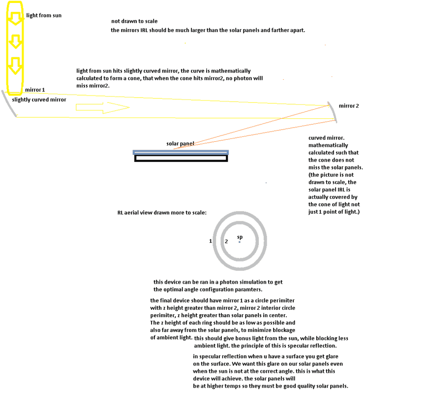

thought of another idea, what if you put a bunch of mirrors to boost power on cloudy days... these mirrors work like a periscope to reflect off two angles, there is no limit to how many mirrors cause you can spread 'em apart at any distance...
i am wondering will this work for more help than just cloudy days?... for instance, can a solar panel use the power of two suns, or is it maxxed at only just one sun before the max power is achieved?... if you can get solar panels to accept the power of 10 suns or more the power is astronomical, assuming the actual photon waves do not cancel each other out...
if this idea is useful please consider giving me a nobel prize someday...

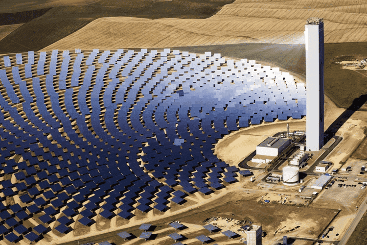

Like this, perhaps? For a sense of scale, see the cars in the parking lot at lower right.
That is Solar One in the Mojave Desert (California). It was retired in 1988. This is a Solar Thermal unit. The top of the tower, operating at 1000°F, has molten salt circulating in it as a thermal transfer fluid. Then water is boiled to drive a conventional steam turbine/generator system.
Photovoltaic cells are destroyed at those temperatures.
Solar Two and a bit more info at:
https://www.atlasobscura.com/places/solar-one-and-solar-two
Also:
https://climatekids.nasa.gov/concentrating-solar/
But they are V-E-R-Y slow to connect, it may take a few tries.
Cheers,
Tom

@paradisePhysicist: With PV this is generally known as concentrator PV. You save some PV area but you increase the complexity of the system, you generally need tracking to follow the Sun, you create heating issues, and it only helps with direct sunshine - on cloudy days your mirrors are not brighter than the sky they obstruct.
Also:
Cheers,
Tom
Gotta note the solar thermal plant that Ore-Ida built in Eastern Oregon to fry french fry potatoes.
