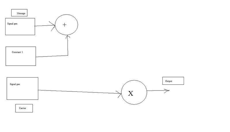

This is not a HW question but an activity i am working on. The attachment is a symbolic AM transmitter.
The carrier is 15MHz and message frequency is 2Mhz.
I want to sketch the waveforms labelling them in as much detail as possible.
Also sketch the output waveform in both time and frequency domains and calculate its bandwidth (a paint rough drawing would be helpful)
If the signal was alternated with a 2kHz tone every 0.25s, sketch output waveform in both time and frequency domain and calulate its bandwidth. Repeating this with commercial speech replacing the message tone.

I'll try to see how I can help. First you need to understand how the conventional AM envelope method works. Basically firstly a DC signal is added to the message signal to ensure that the signal varies over the positive values only (think of it as the message signal being elevated above the axis). Then this signal is next mutiplied by a carrier of much higher frequency in this case 15MHz. The message signal as you've clarified in the other thread has frequency of 567Hz.
The diagram you provided is missing an arrow from the carrier to the multiplication operation. Once this is done, the resulting waveform wil display on its envelope a shape which is similar to that of the original message signal.
Now for sketching it in the frequency domain. Suppose the carrier is [tex]\cos (2\pi 15 \cdot 10^6t)[/tex].
Then the message signal after adding the DC signal and multiplying by carrier is:
[tex](\alpha + x(t))\cos (2\pi 15 \cdot 10^6t)[/tex].
Now to sketch this in the frequency domain you have to first Fourier transform the above. How do you do transform the cosine carrier wave? Firstly express it in terms of complex sinusoids, then F.T. the complex sinusoids using the table of Fourier transform. When you're done with this, remember next that multiplication in the time domain corresponds to convolution in the frequency domain. What is the result of convoluting a X(f) (the FT of the messge signal) with the FT of the cosine carrier wave? There's a special result you might need here.
When you're done with that, you're ready to sketch the diagram. Remember that for all real signals, the corresponding magnitude spectrum has to be symmetric. Once you've got the diagram you should be able to deduce the bandwidth of the resulting signal.

Without even trying to draw it, the 20 MHz signal looks like a sinewave.
When the 1 KHz signal is added, the 20 MHz sinewave is still a sinewave, but it varies in amplitude at a 1 KHz sinusoidal rate.
If you looked at it on a CRO you would see a sinewave along the top of the 20 MHz signal (which would look like a blur if you could see the 1 KHz signal) and another sinewave along the bottom of the 20 MHz signal. The one at the bottom would appear upside down compared to the one at the top, so they tended to meet in the middle on negative going half cycles.
