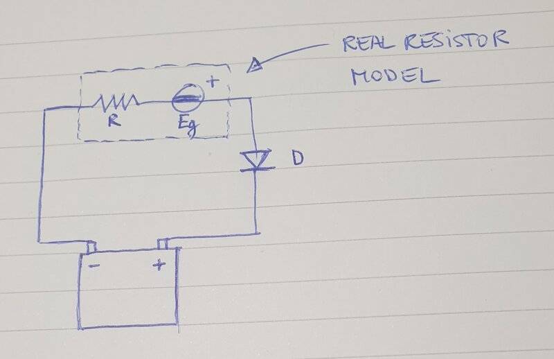

Hi, soppose we have a resistor at a given temperature T connected through a diode to a cell battery.
The voltage accross the resistor due to thermal noise should charge the cell converting termal energy into chemical energy without limits.
Does the above process violate the second law of thermodynamics ?

See for instance Nyquist noise. Suppose the resistor's Thevenin model with a voltage source is connected through a diode to a cell battery. This way the cell battery stores chemical energy from thermal energy without limits.
cianfa72 said:
See for instance Nyquist noise. Suppose the resistor's Thevenin model with a voltage source is connected through a diode to a cell battery. This way the cell battery store chemical energy from thermal energy without limits.
Draw and label a diagram, being very specific about what you think is happening (the numbers)
This is the diagram.
The diode D allows current to flow only in the cell recharging direction.
And what is the V-I characteristic of this diode at thermal noise voltages? (Hint: be sure to consider the reverse saturation current value...)
$$i= I_s(e^{v/V_T} - 1)$$ where ##V_T \approx 26 mV## at ##T=300K##.
Correct, and how much rectification action do you get for small AC voltages about zero Volts? :wink:
Expanding the I/V curve by Taylor series around ##v=0## we get $$i \approx \frac {I_s} {V_T} v$$ i.e. the diode acts as a resistor of ##V_T/I_s## ohms for small AC voltages. Therefore there will not a net flux of energy recharging the cell battery :smile:
