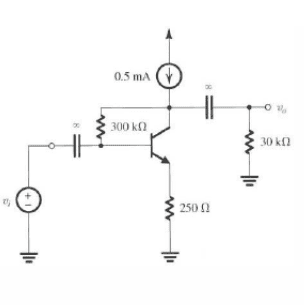

For beta = 100 and assuming ro is very large, what is the DC voltage at the collector?
IB = IE(β+1)
IC = β*IB
Since IE = 0.5mA, IB = 0.0505 A
Then, IC = 5.05 A (which doesn't feel right)
VC is the same potential across the 30kΩ load?
I tried doing KCL with those currents (to find the current thought the load resistor).
Should I not be analyzing the direct circuit--should I make an equivalent T-model?

Your equation should read ## I_E=I_B (\beta+1) ##. Try again. I think you also need to assume ## V_{BE}=.7 \, volts ## (approximately). One hint for you: The capacitors basically block any steady state current trying to go through them so the capacitor is an open circuit for the DC part of the analysis.
