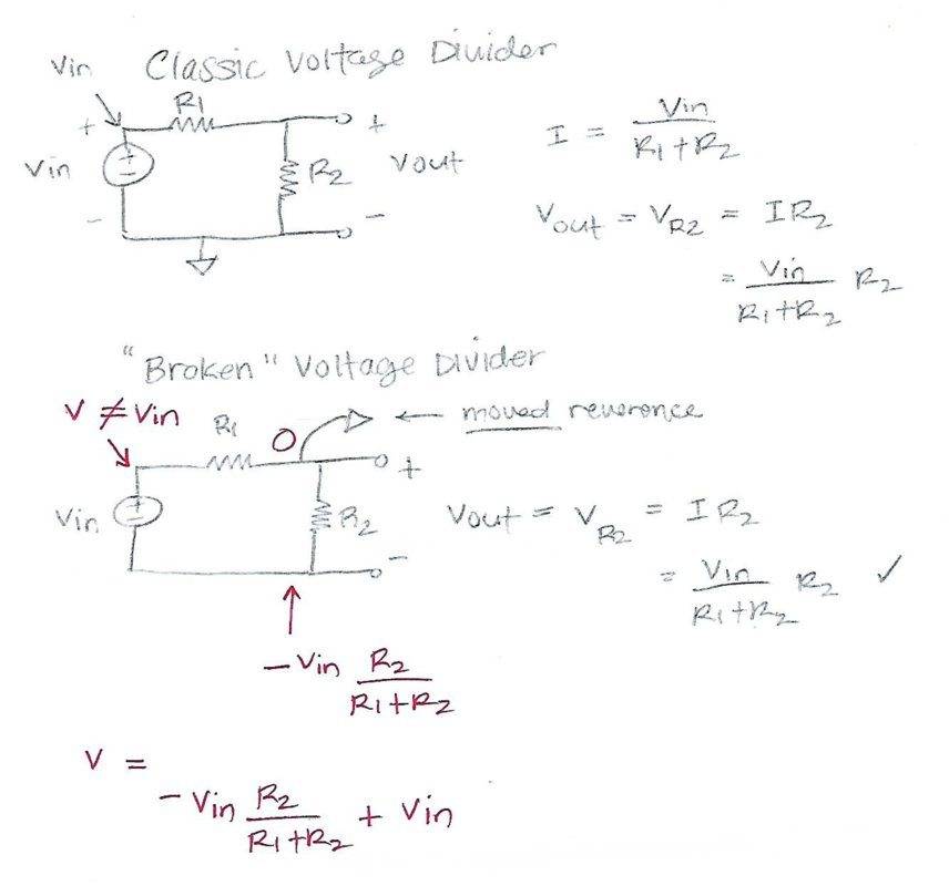

Something that helped me clear this up was trying ideas on circuits I was more comfortable with. That would be a voltage divider for me. What I did is I "broke" the voltage divider by moving the reference (ground) to where I normally like to see ##V_{out}##. What I saw is the voltage across each element did not change. To solve this "broken" voltage divider I thought of ##V_{out}## as the voltage across ##R_2## and you'll get the exact same answer even though the voltage at my preferred node is now ##0##. The node above ##V_{in}## with this configuration is also no longer ##V_{in}## because ##0## was no longer right beneath it (however the voltage across ##V_{in}## is still ##V_{in}##).
