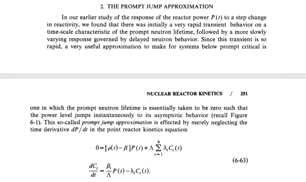

Consider the mono-group model and a ramp in reactivity like ##\rho = -\gamma \beta t##
The system is
$$\frac {dP}{dt} = \frac {\rho - \beta}{\Lambda} P + \lambda C$$
$$ \frac {dC}{dt} = \frac {\beta}{\Lambda} P - \lambda C$$
1st method: assume that the concentration of precursor doesn't change significantly (and it is equal to ##C_0##). The differential equation to solve is thus:
$$\frac {dP}{dt} = \frac {\rho(t) - \beta}{\Lambda} P + \lambda C_0$$
The solution is:
$$P(t) = \exp{- \left( \frac{\gamma t^2 } 2 + t \right) \frac {\beta}{\Lambda}} \left[ \lambda C_0 \int_0^t \exp{- \left( \frac{\gamma t'^2 } 2 + t' \right) \frac {\beta}{\Lambda}} dt' + P_0 \right]$$
for ##t \rightarrow 0## ##P(t) \approx P_0(1 + t)## ?? How can the power increase if I insert negative reactivity ?!
2nd method: Prompt Jump (since the reactivity is negative)
the solution is
$$P(t) = P_0 \exp{-\lambda t} (1 + \gamma t)^{-1 + \frac {\lambda}{\gamma}}$$.
Again if ##\gamma < \lambda## then for ##t \rightarrow 0## ##P(t) \approx P_0(1 + \gamma t)^{\frac {\lambda - \gamma} {\gamma}} ## increases!
I checked my result, the math should be fine.
Any help would be greatly appreciated.

rpp said:
The prompt jump approximation *is* to assume that the precursor population doesn't change,
No... The prompt jump approximation is very different. If the reactivity is very far from prompt critical (##\rho << \beta##) then we can drop the time derivativa w.r.t ##P##, i.e. -as my professor likes to say- we remove the dynamics from the system. The equations then becomes:
$$ 0 = \frac {\rho - \beta}{\Lambda}P + \lambda C$$
$$\frac {dC}{dt} = \frac {\beta}{\Lambda}P - \lambda C$$

dRic2 said:
Thanks for the replay. :smile:No... The prompt jump approximation is very different. If the reactivity is very far from prompt critical (##\rho << \beta##) then we can drop the time derivativa w.r.t ##P##, i.e. -as my professor likes to say- we remove the dynamics from the system. The equations then becomes:
I don't think this is correct. The prompt jump assumes the precursors are constant, not the power. Physically, you are looking for the change in power after a step reactivity change. The prompt neutron population starts to increase/decrease almost instantaneously, but it takes a while for the precursors to "catch up". This initial change in power is the "prompt jump".
No. Setting the derivative equal to zero is not a way to say the the power is constant. To avoid more confusion I'll post a page from "Nuclear Reactor Analysis" by Duderstadt & Hamilton.

rpp said:
Likewise, for Method 1 you set some of the ttt terms to zero, but kept other ones. I'm not sure this is justified.
In both cases I was wrong... o:) o:) Sorry... Both my Taylor expansions were wrong! Thank you for spotting my mistake. Now I solved the issue with Method 1 (see below), but still got a problem with Method 2
For method 1 things are a little complicated. The problem is to approximate the integral
$$\int_0^t \exp{- \left( \frac{\gamma t'^2 } 2 + t' \right) \frac {\beta}{\Lambda}} dt'$$
We are lucky it is a gaussian! If we consider a time interval ## t << \frac {\Lambda} {\gamma \beta}## and close to zero, we can see from the graph that the curve is more or less constant and so we can take it outside the integral
$$\exp{- \left( \frac{\gamma t^2 } 2 + t \right) \frac {\beta}{\Lambda}} \int_0^t dt' = \exp{- \left( \frac{\gamma t^2 } 2 + t \right) \frac {\beta}{\Lambda}} t$$
If you put this thing into the final equation of Method 1
$$P(t) = \lambda C_0 t + P_0\exp{- \left( \frac{\gamma t^2 } 2 + t \right)\frac {\beta}{\Lambda}} \approx \lambda C_0 t + P_0 \frac {\beta}{\Lambda} (1 - \frac{\gamma t^2 } 2 )(1 - t) $$
Recalling that ##\frac {\beta}{\Lambda} P_0 = \lambda C_0## we see that the terms containing ##t## cancel out leaving only the higher terms. So in conclusion ##P(t) \approx 1 - t^2 ## which is physically reasonable.
Method 2.
Here is the correct way to do it:
$$e^{-\lambda t} \approx 1 - \lambda t + o(t)$$
$$(1 + \gamma t)^{\frac{\lambda - \gamma} {\gamma}} \approx 1 + {\frac{\lambda - \gamma} {\gamma}} t + o(t)$$
So
$$P(t) \approx (1 - \lambda t )(1+\frac {\lambda - \gamma} {\gamma}t) = 1 - \lambda t + \frac {\lambda - \gamma} {\gamma}t - \lambda \frac {\lambda - \gamma} {\gamma}t^2 \approx 1+ \frac {-\gamma \lambda + \lambda - \gamma}{\gamma} t$$
If ##\gamma < \lambda## then ##\gamma \lambda \approx 0## because usually ##\lambda = 0.008s^{-1}## (but for very fast transient this value could change very much!) so I still get something that is increasing.
