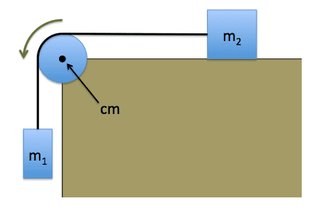

A block of mass m1 is attached to a block of mass m2 by an ideal rope passing over a pulley of mass M and radius R as shown. The pulley is assumed to be a uniform disc rotating freely about an axis passing through its center of mass (cm in the figure). There is no friction between block 2 and the surface. Assume that the pulley rotates counterclockwise as shown with an angular speed ω and that the rope does not slip relative to the pulley, and that the blocks move accordingly and do not topple or rotate.
Consider the system to be formed by the pulley, block 1, block 2 and the rope.
1. Calculate the magnitude of the angular momentum of the system about the center of mass of the pulley. Express your answer in terms of some or all of the variables m1, m2, M, R, ω and g.
2. Find the pulley's angular acceleration. Express your answer in terms of some or all of the variables m1, m2, M, R, ω and g.
angular momentum = moment of inertia x angular velocity
moment of inertia = mass x radius squared
torque = moment of inertia x angular acceleration
for the first part my answer was ((m1+m2)*v*R)+(M*omega*R^2)
for the second part ((m1*g)/(m1+m2+M))/R
i just need to know what I'm doing wrong

as shown
Shown where?
This is true for point-masses only, it is not true for disks.

Your moment of inertia of the disk is wrong.
Also, I hope you realize that, in your angular momentum equation, v = ωR.

How are we supposed to tell unless you show your work? Just posting your wrong answers isn't very helpful.
That is wrong. The moment of inertia of a homogeneous disk is mR2/2.
