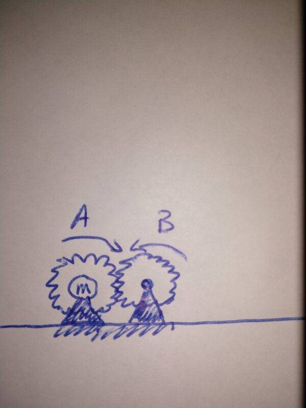

Say we have a motor attached to the Earth with gear A, that drives identically sized gear B. Gear B spins on its own axis and but is also attached to ground. Torque between gears is equal.
Technically each gear has equal but opposite AM right, but If I take Earth into account, how is Ang. Momentum conserved?
Which axis do I use? Axis of A or B?
I understand AM for simple problems, but this got me thinking. Maybe this is a bad example and requires clarity so please let me know.
Thank you
You can use whatever coordinate system you want, it's axes don't need to coincide with the rotation axes of the gears.
Anyway, you'll need to give more details about your setup. What do you mean by 'attached to the ground', do you mean the axle is fixed? Is there friction at either of the axles? If one gear is being driven by an external motor, then that's one pathway by which angular momentum is being transferred to the system.

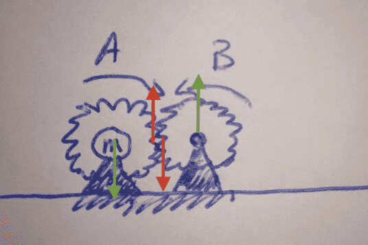

I was assuming no friction. Gears and motor are attached to ground as shown, fixed rigidly. I don't exactly how you would shown AM is conserved here as all my examples in my old physics books are about one simple axis
Have a look at the forces I've labelled in, assuming (to keep things simple) that the gears are massless, the axle frictionless, and the forces between the gears are vertical.
The forces exerted by each gear on each other are shown in red, and the contact forces from the hinge on the gears are shown in green [remember that the net force on any gear must be zero, since its centre of mass is not accelerating!]. The motor also exerts a driving couple moment on gear A.
Notice that the green contact forces form a couple, whose torque on the 2-gear system is the same in any coordinate system. The couple moment exerted by the motor on the gear A, and by extension the 2-gear system, is also the same in any coordinate system. The total torque of the two red forces is zero in any coordinate system.
The no-slip condition tells you that, if the gears are identical, the total angular momentum of the system is always zero. This means that the torque of the motor is exactly opposite to the torque of the couple formed by the two contact forces at the axles!

So are you taking the motor torque about the axis of A and saying it is equal and opposite to the couple in green about the same axis? If so then I see my mistake and how it balances.
That works, yes. But the 'motor' can be replaced equivalently by two oppositely directed, tangential forces on opposite sides of the gear A, i.e. a force couple. That means that the torque of the motor is the same when calculated w.r.t. any coordinate system, and consequently there's no benefit in this case in picking a coordinate system whose origin is at the centre of A, as opposed to anywhere else.
This is a useful property of couples. If in one coordinate system the torque of a couple is$$\vec{\tau} = \vec{r}_1 \times \vec{F} + \vec{r}_2 \times (-\vec{F})$$then the torque w.r.t. another coordinate system whose origin is displaced by a vector ##\vec{R}## will be$$\vec{\tau}' = (\vec{r}_1 - \vec{R}) \times \vec{F} + (\vec{r}_2 - \vec{R}) \times (-\vec{F}) = \vec{r}_1 \times \vec{F} - \vec{r}_2 \times \vec{F} = \vec{\tau}$$i.e. ##\vec{\tau} = \vec{\tau}'##.

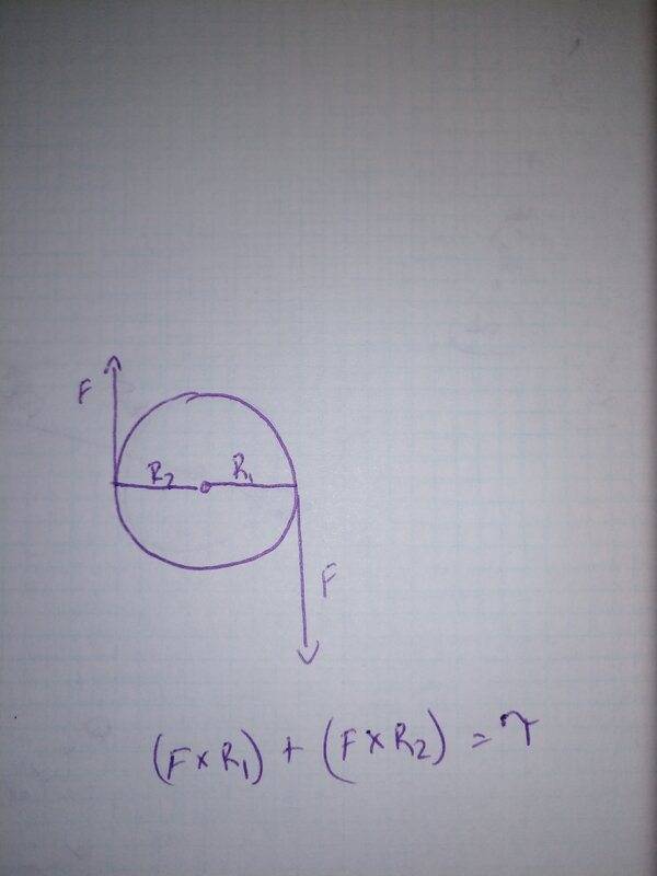

Isnt the math wrong here... if i have a couple shouldn't Fxr1 be added to FxR2? Seems to be an extra minus sign.
I definitely did it right, promise!
what am i doing wrong. If i have a couple, two equal forces F, I have to multiply them via their radius and add together. See diagram below
If there is another axis, i agree i can find the same torque, but my formula would be the distance from the new origin to existing axis Rnew as such that;
(Rnew + r1)F - (Rnew -r2)F.
we might be saying same thing. I see you wrote in vector format where i am not. IF you have force Vector F, but it is opposite of the other force vector F, then the negative in front makes it makes sense to what i wrote above
Yes, I think that it is the discrepancy in sign convention. Choosing to put the signs into the values and leaving the formula pristine. Or putting the signs into the formula so that all of the values can be positive.
Only the first option is correct reasoning, second option is just fudging 🤭
