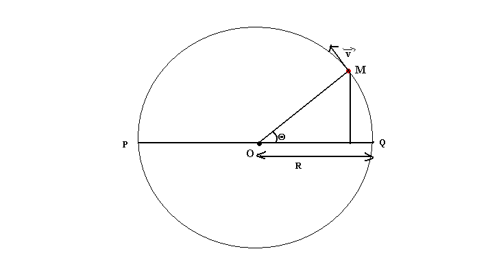

A particle of mass m moves in a circle of
radius R at a constant speed v. Assume: The
motion begins from the point Q, which has
coordinates (R, 0).
Determine the angular momentum of the
particle about point P, which has coordinates
(−R, 0) as a function of time.

Look at the figure attached .O is the origin.The coordinates of Q are ##R \hat{i}## whereas the coordinates of P are ##-R \hat{i}## .Let the particle be at M at any time 't' making an angle θ with the horizontal.
All you have to do is calculate ## m(\vec{PM} \times \vec{v})## .
1. First express θ in terms of v,R,t .
2. Write down the coordinates of M .
3. You already have coordinates of P given . So calculate ## \vec{PM}##
4. Find the component of velocity at point M in 'x' and 'y' direction . From that express velocity vectorially .
Now perform the cross product . Be careful with trigonometric identities .You will get the elusive 1 .

Well, in that case we won't be needing the drawing I had already prepared when Tanya beat me to it :frown:.
For the sake of others listening in: what did you do and how did you do it ?
\vec{L} = \vec{r} \times m\vec{v}
The angular displacement around the circle:
θ = ωt = \frac{vt}{R}
The vector from the center of the circle to the mass is then:
Rcos(θ)i + Rsin(θ)j (in the i and j directions)
The vector from the point P to the point of the mass is:
\vec{r} = R\hat{i} + Rcos(θ)\hat{i} + Rsin(θ)\hat{j}
\vec{r} = R[[1+cos(\frac{vt}{R})]\hat{i} + sin(\frac{vt}{R})\hat{j}
The velocity vector
\vec{v} = -vsin(\frac{vt}{R})\hat{i} + vcos(\frac{vt}{R})\hat{j}
So,
becomes
\vec{L} = m v R {[1 + cos(ω t)]\hat{i} + sin(ω t)\hat{j}}
× [− sin(ω t)\hat{i} + cos(ω t)\hat{j}]
= m v R {[1 + cos(ω t)] [cos(ω t)] −[sin(ωt)] [− sin(ω t)] }\hat{k}
= m v R [cos(\frac{vt}{R})] + 1]\hat{k}
