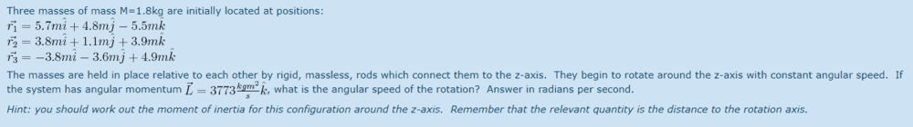

See attached
L=rotation rate*I
First I found the moment of inertia,
I=1.8(5.5^2+3.9^2+4.9^2)
=125.046
Then I tried to find the rotation rate using the equation L=rotation rate*I
rotation rate=3773/125.046=30.173
But the answer is suppose to be 21.263?
No. The rotation is about the z (k) axis. What are the distances from that axis?
Doesn't k hat represent how far something is from the z axis?
No, it is how far it is along the z axis. And you mean the coefficient of ##\hat k##. ##\hat k## is the direction of the z axis.
You have to use pythagorean theorem on the i and j coordinates to find the distance from the z-axis.
