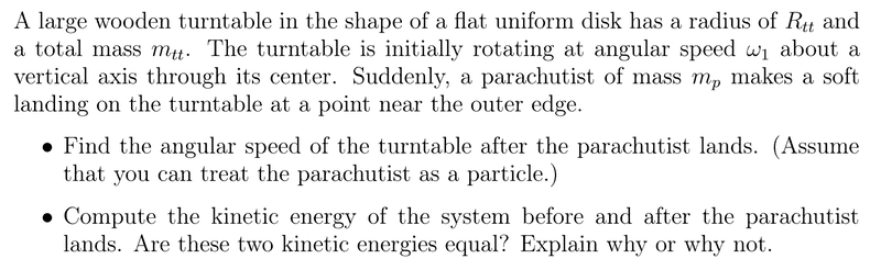

Typeset physics problem text describing a uniform wooden turntable of radius R_tt and mass m_tt spinning at angular speed omega_1, with a parachutist of mass m_p landing near its edge; two bulleted questions follow.

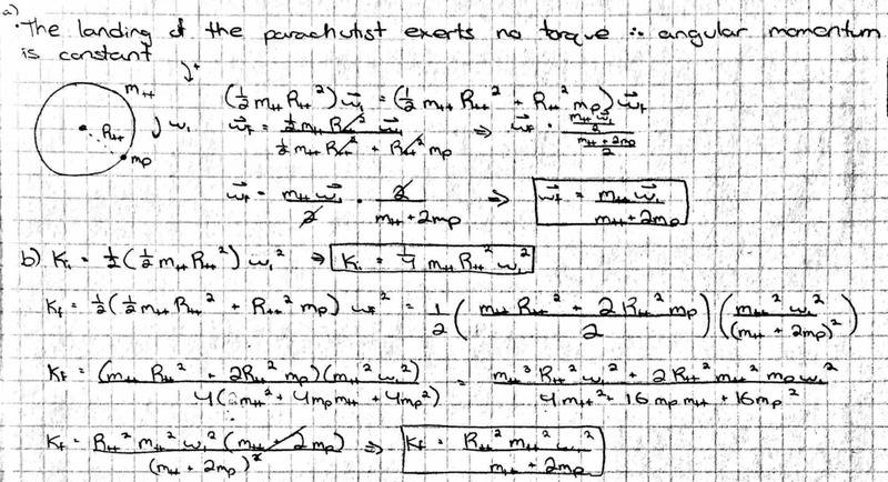

Li = Lf
L = I*omega
K = (1/2)*(I)*(omega)^2
Handwritten derivation on grid paper of angular momentum conservation for a turntable with a person at its edge, showing expressions for final angular velocity and kinetic energies before and after, with boxed results.
[/B]
Given that there are no non-conservative forces in action, I am assuming that the two kinetic energies should be equal. However, as shown by my work above, the two values are different, and I do not know where I went wrong.
  • Typeset physics problem text describing a uniform wooden turntable of radius R_tt and mass m_tt spinning at angular speed omega_1, with a parachutist of mass m_p landing near its edge; two bulleted questions follow.

  • Handwritten derivation on grid paper of angular momentum conservation for a turntable with a person at its edge, showing expressions for final angular velocity and kinetic energies before and after, with boxed results.
This is not correct. Compare with the case of a clump of clay with some velovity hitting another stationaty piece of clay and sticking together. Is the kinetic energy the same before and after?
How would you describe the collision between the parachutist and the rotating disk?
