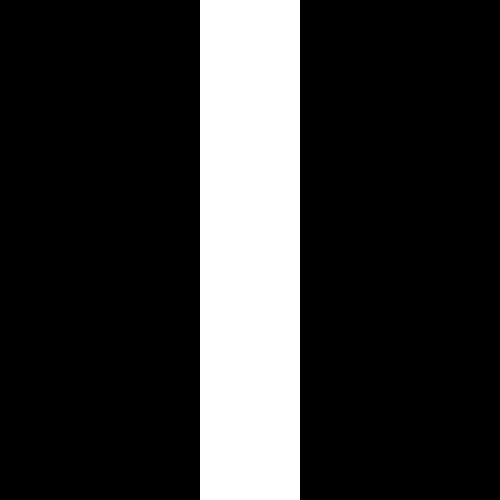

I got these images from a numerical simulation of the Angular Spectrum Method and the Fourier Transform.
Black image with a single vertical white slit in the centre, the slit occupying about one fifth of the image width and spanning its full height.
This is my aperture. A slit with a width of 100 pixels.

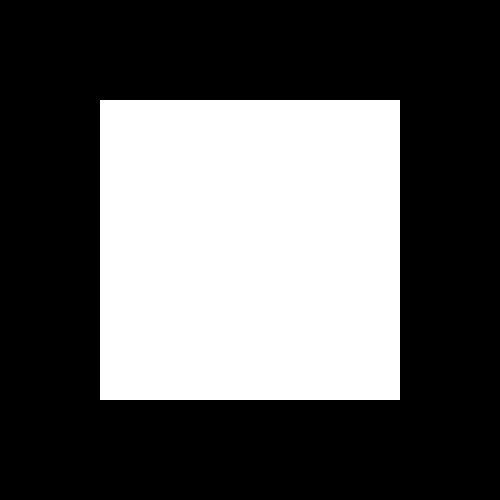

What about simulating a more realistic rectangular aperture?
This is the square aperture with 200 pixels on each side, or 0.04 meters on each side.
Plain white square on a black background, centred in the frame, with no labels, axes or other visible content.

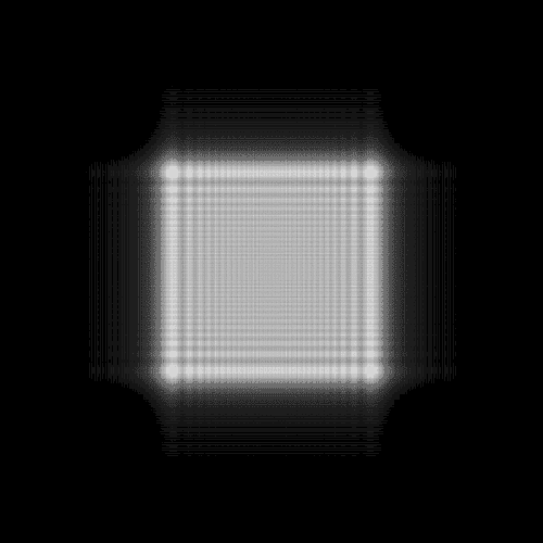

This is the Angular Spectrum result:
Grayscale simulated diffraction pattern of a square aperture: a bright square with glowing corners and streaky fringes spreading outward along the edges.
And this is the Fourier Transform:
Simulated diffraction pattern of a square aperture: a bright square-shaped intensity distribution with blurred fringes and ringing extending outward on a black background.
It's somehow the same with the slit. The diffraction pattern is smaller for the Fourier Transform.
Ok assuming the other dimensions used are those given in your previous comment, I guess your experimental condition already satisfies the requirement for Fresnel approximation. Now what program do you use to calculate those images, MATLAB? If yes did you calculate the FT using the build-in function such as fft? As far as I know, when you use such build-in function, the coordinate scaling in the target plane is already determined by the function, therefore the scaling on the coordinate on both pictures above may be different, can you also check this?
In any case, the Fresnel integral can be shown to coincide with the angular spectrum method provided paraxial approximation is valid within the problem considered, I don't see any reason why the two ways should differ even in scaling.
