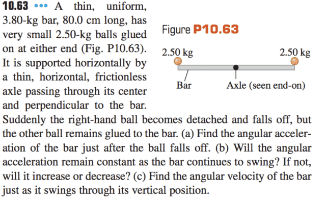

In particular I am only looking at part c.
I know the simpler approach is to use energy.
But I am thinking if i can do an integration of all the torque throughout the process, and hence find the integration of the net angular acceleration and find the resultant change in angular velocity.
But I have no idea how to do the mathematics. Can anyone show me how the mathematics is done?

… if i can do an integration of all the torque throughout the process, and hence find the integration of the net angular acceleration and find the resultant change in angular velocity.
τ = Iα …
torque (of the weight) = 1/3 ML2 d2θ/dt2 :wink:

hey thanks for the help.
sorry but I still don't know how to go on from here!
could you elaborate a bit further!
In particular I was looking at using the 'infinitesimal' dτ or dα approach.

there is no dτ or dα in this situation :confused:
use torque (of the weight) = 1/3 ML2 d2θ/dt2
what is the torque? (as a function of θ)​
