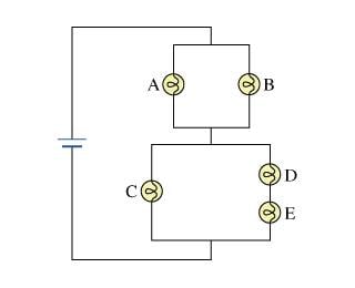

I am trying to find the order of brightness for the lightbulbs; I know that it will depend on the fraction of voltage divided among the lightbulbs and I know the voltage is divided across the each bulb depending on the resistance encountered in each pathway (with D and E in series with each other), but from there I'm not sure how to set up a fraction for the division of voltage, any help is greatly appreciated.
Let each lightbulb have a resistance of R. How is the voltage divided between the upper pair vs. the bottom three bulbs?
just looking at the diagram I would say 2/3 but I'm not sure that's correct, considering D and E are in series with each other.
No. Use the rules for combining resistors in parallel & series.
What is the net resistance of the upper pair?
What is the net resistance of the lower 3-bulb combination?

well for D and E Rtot1 = Rd+Re
for the others that are in parallel, 1/Rtot = 1/Ra+1/Rb or I/Vab = 1/Ra+1/Rb
and C is in parallel with Rtot1 so 1/Rtot2 = 1/Rtot1+1/Rc or I/Vtot2 = 1/Rtot1+1/Rc
so Rtot for a and b is Ra+Rb/RaRb
and Rtot2 = Rtot1Rc/Rtot1Rc
so these would add up and give me the total resistance on each bulb?
okay, I added up all the resistances and got this:
3/2R (the resistance of the 3 bulb combo) and 2/R (the upper pair) = 7/(2R) as the total resistance is this correct?
also, since I need to find the current through bulb c, so I'm thinking I just need the resistance of the 3bulb combo and they're potential difference between the bulb c and the bulbs d and e.
No.
3/(2R) is the reciprocal of the resistance of the 3-bulb combo.
2/R is the reciprocal of the resistance of the upper pair.
