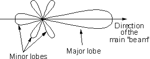

What does this diagram represent?
Polar radiation pattern of an antenna: a large major lobe extends to the right along the direction of the main beam, labelled Direction of the main beam, with several smaller minor lobes pointing in other directions from the origin.
Is that the intensity of the cosine function given some spatial variable? So when we check the intensity in the "main" direction of the beam we may have, A(t)cos(O(t)) but if we angle off from the "main" direction we may have B(t)cos(O(t)) where A > B?Any help, or references to this would be highly appreciated.

The diagram you show is for a multi-element antenna array, which has its main beam to the right. You could get this pattern with a multi-element Yagi antenna, for example, where the dipole elements are vertical, and you are looking down on the antenna and radiation pattern from above.
Think of a 2-element vetical dipole array, where you have two dipole antennas spaced a quarter wave apart, and fed with waveforms that are a quarter wave out of phase. In one direction the vertically polarized (E-field) waveforms will add in phase, and in the other direction they will cancel. This gives you a front-to-back directionality asymmetry in the radiation (and receiving) gain pattern. I believe that with the 2-element array I just described, that you only get one main lobe, and one zero-gain direction.
With more than 2 elements, or a 2-element array with wider spacing or different phase feeds, you will get multiple cancellation directions, and multiple lobes where the signal gain is bigger or smaller. The graph above shows the gain as a function of azimuth (again, assuming you are looking down on a vertical antenna array).
Hope that helps. Post more specific questions after you get a chance to read through the google hit list.

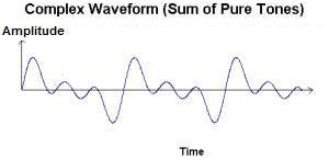

It sounds like you are trying to picture what the signals look like as they radiate from the antenna. What berkeman has explained does hold for a complex waveform being transmitted over a carrier wave. As you've noted, the information signals may be thought of as the summation of cosine functions (or sine functions if you like). Viewed on an oscilloscope, they won't resemble a cosine function. They appear as a complex wave.
Here is an example of a complex wave made up of pure sinusoids
Plot titled Complex Waveform (Sum of Pure Tones) showing amplitude against time, with an irregular wave that has several peaks of differing heights around a horizontal time axis.
(ref -- www.acoustics.salford.ac.uk)
Before they leave your parabolic dish, they are modulated (mixed) with single carrier wave at an RF frequency. So the information signals leaving the antenna are not lined up, side by side, as you've indicated. Since information signals are relatively low in frequency, they do not radiate from an antenna. For example in an AM or SSB transmission, once the information signal is modulated with an RF carrier, the carrier frequency dominates the shape and the signals all appear the same, leaving your dish.
